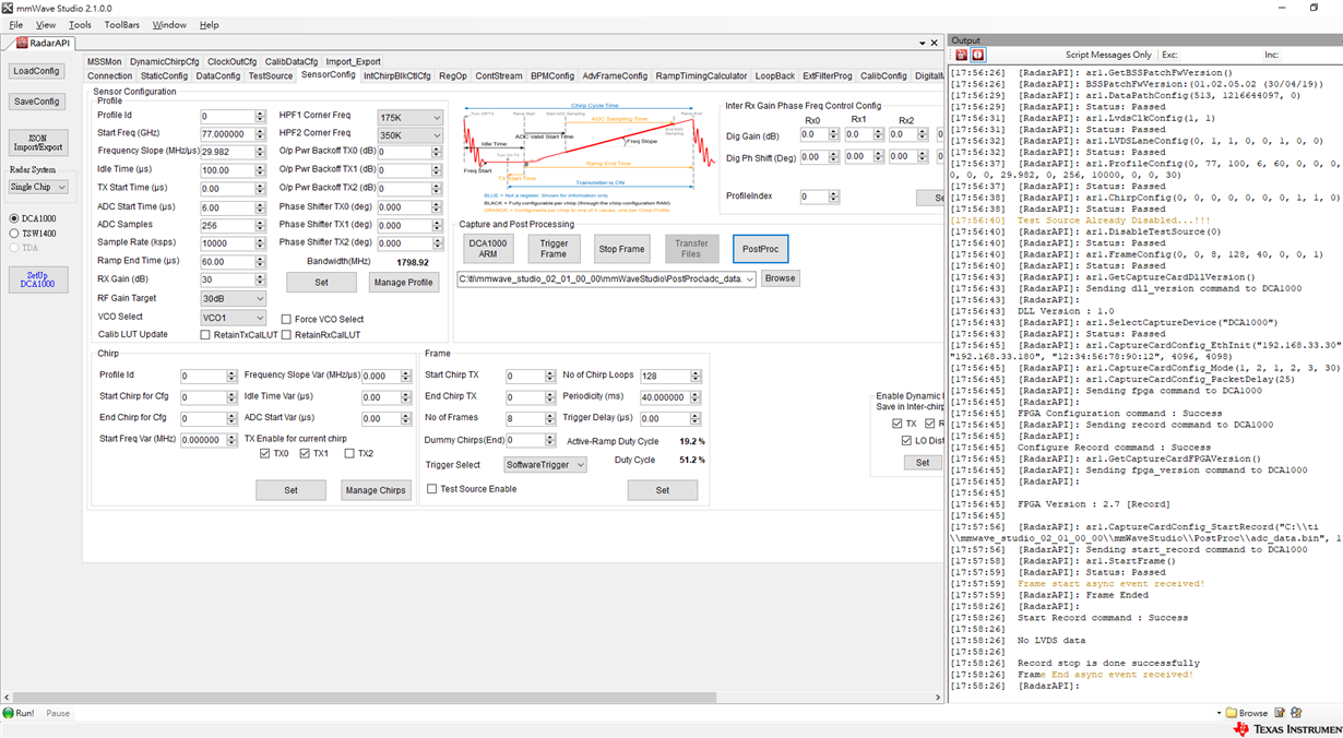

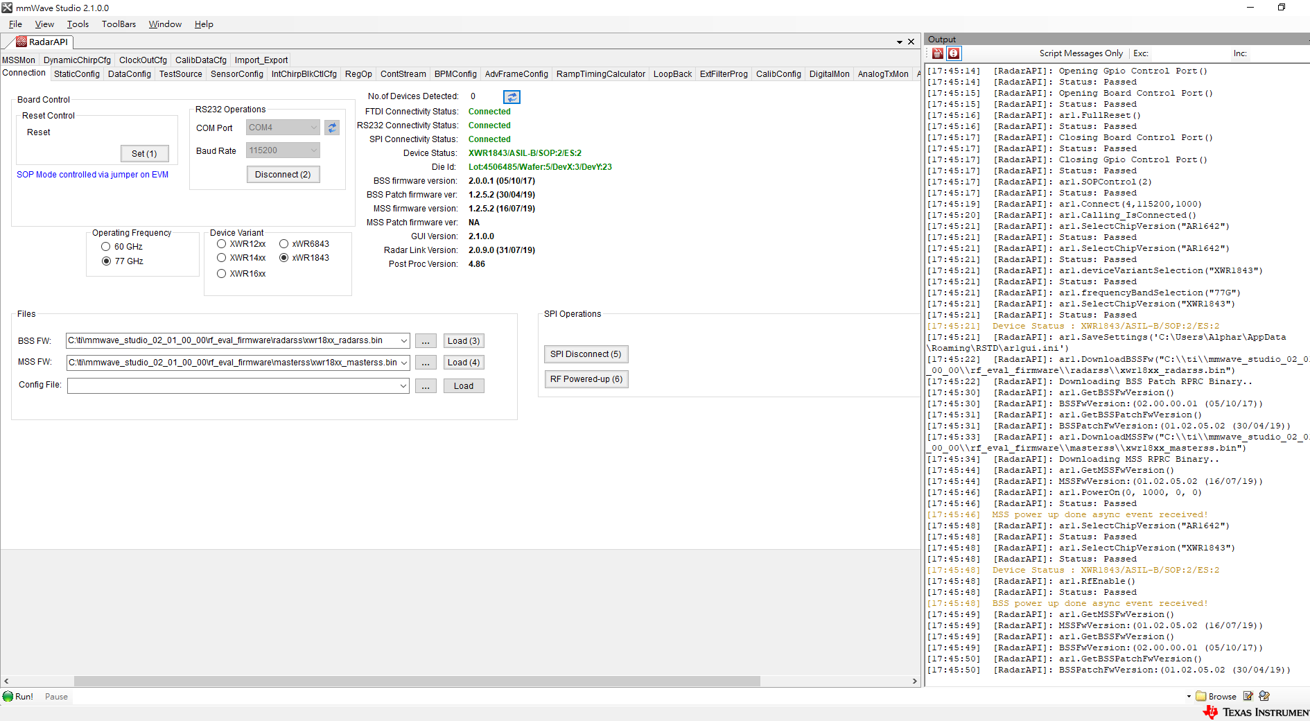

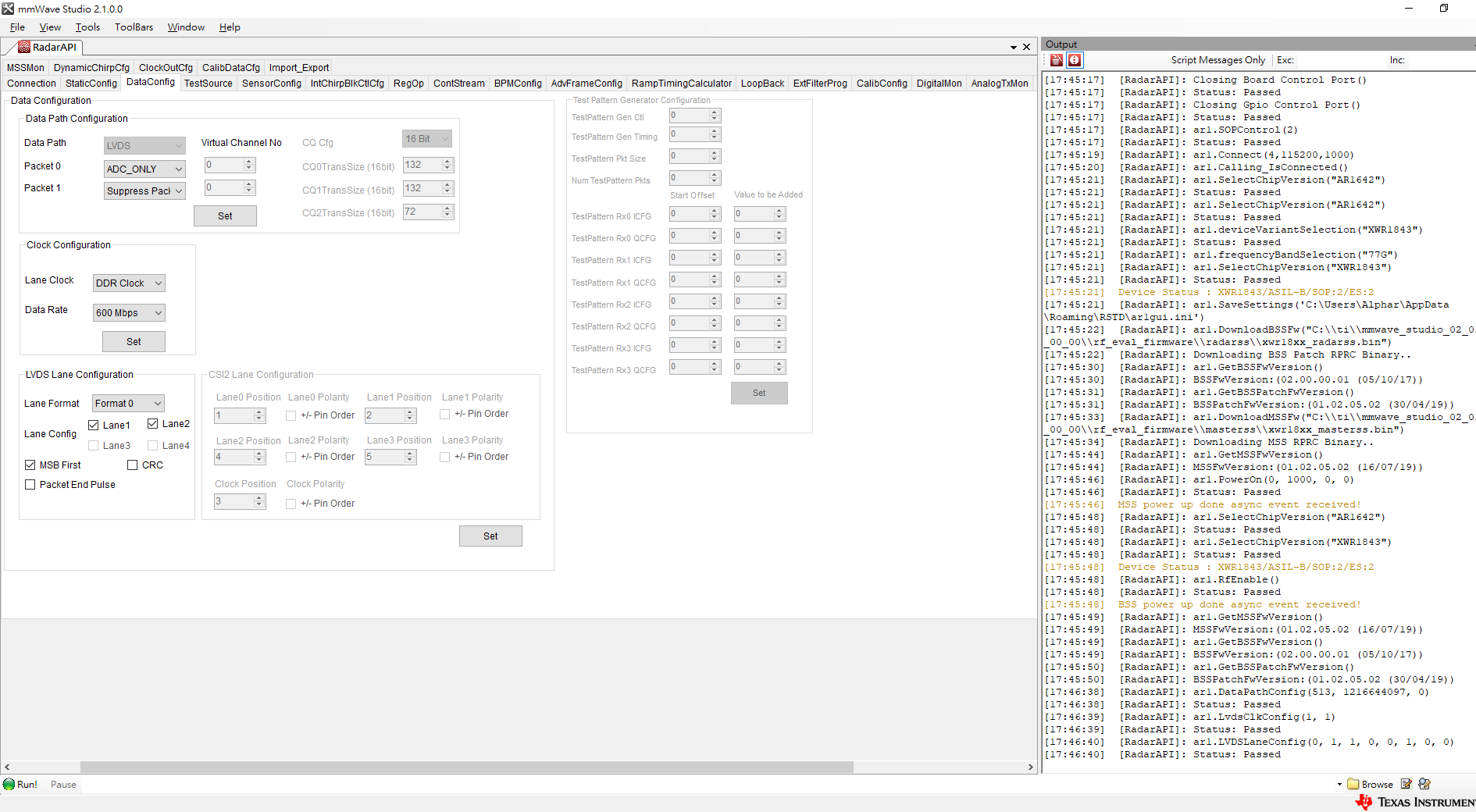

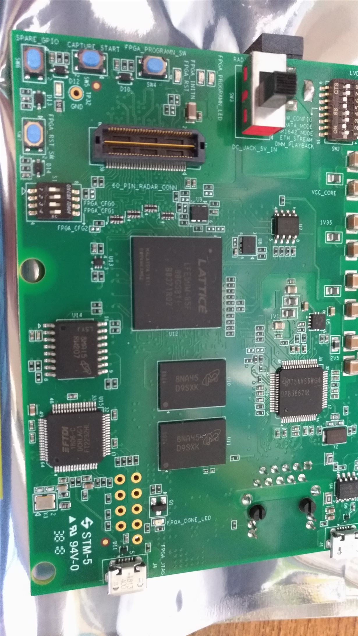

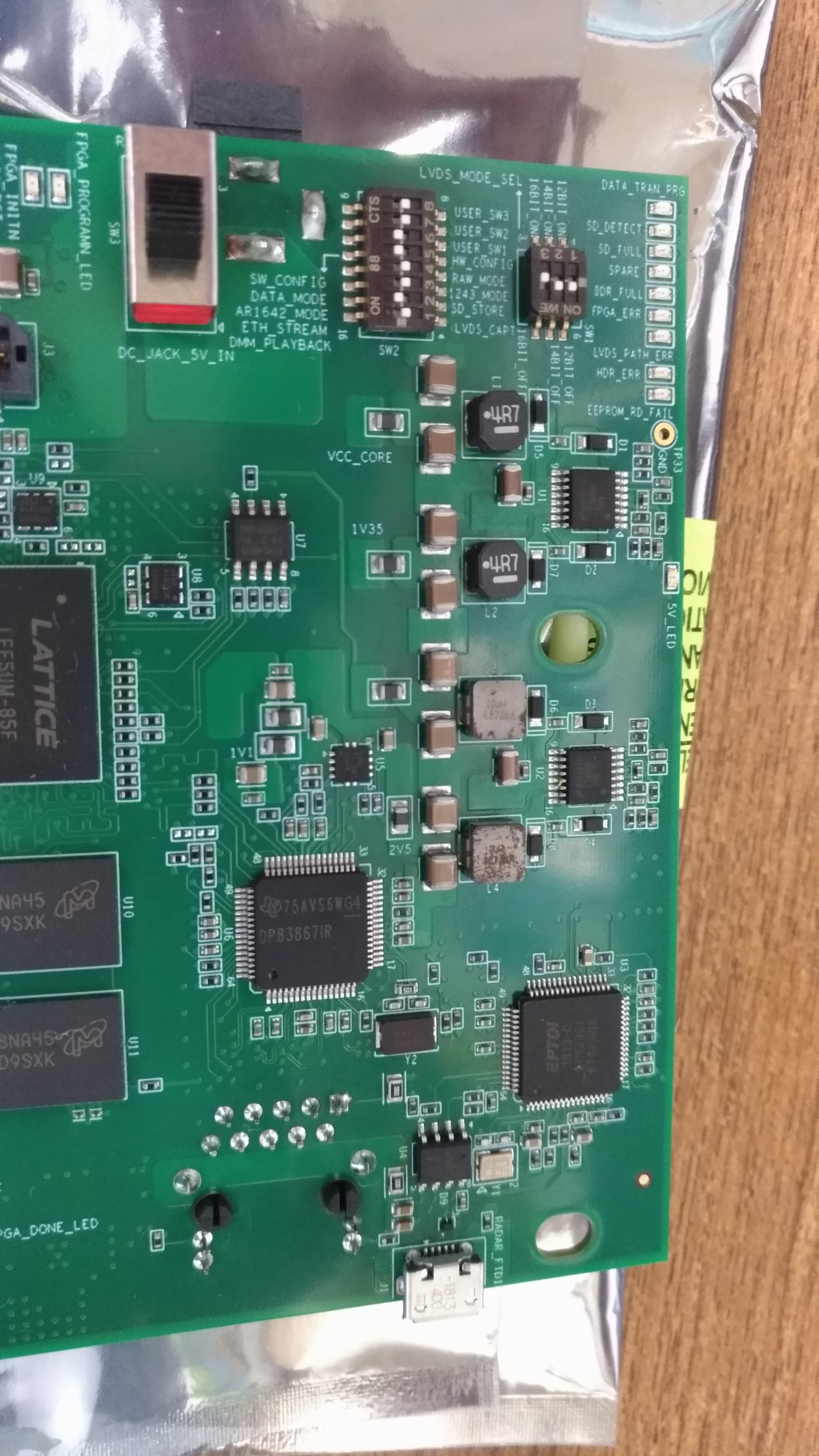

I am using AWR1843BOOST and DCA1000EVM, and I got some problems.

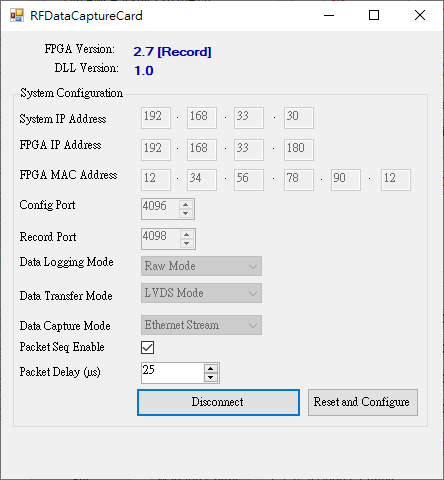

1. After series steps of setting mmWave Studio, when I click "Trigger Frame", the Output message shows "No LVDS data" and I got nothing in the folder where the data "adc_data.bin" should be in. What should I do to solve this problem?

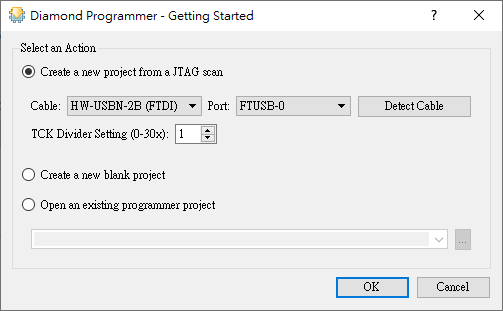

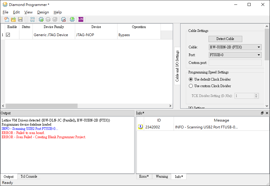

2. Another problem is about SPI flash programming of DCA1000 with the steps in the users guide spruij4a.pdf. I follow the users guide to update flash firmware (try to solve above problem), but it cannot detect the hardware automatically. Although I select the correct hardware manually, it seems that it still cannot know the hardware. What should I do to solve this problem?
The following pictures are the switch setting of my hardware (I have referred to many threads in this e2e forums) and related information about my results.
Thanks for your help.
When programming flash, the information pictures are as follows:
