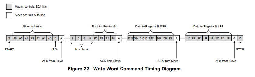

I want to check with you how we should start one-shot operation, what command should I write to TMP117? The datasheet just show I2C command, and didn't see what command, could you help clarify this?

Thanks for the question. In order to start a one-shot, perform an I2C register write command (as shown in figure 22 of the datasheet) to set MOD[1:0] (bits 11:10) in the configuration register (0x01) to 11.
You should ensure that the other configuration settings are not improperly overwritten during this write.
