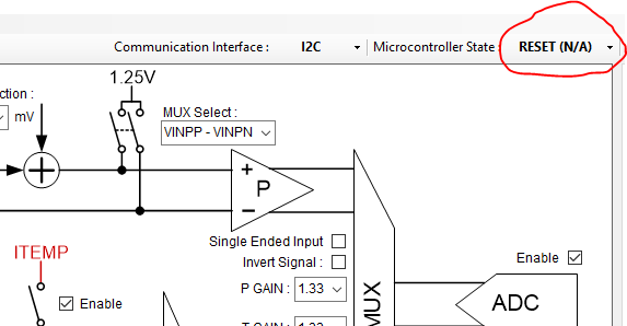

 Q2. Can the offset which the device has be reduced by off set value (-54.75mV~+54.75mV) selecting at "Offset Correction" select window
       on EVM GUI? The customer chaged the value on the GUI. But "PADC_DATA1+2 registers data" was not changed. Do you have any idea about the cause?

    Q2. Has your customer placed the PGA302 in reset? If the device is not in reset, no changes to the registers will be made, and the offset correction will not be updated.
