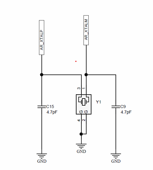

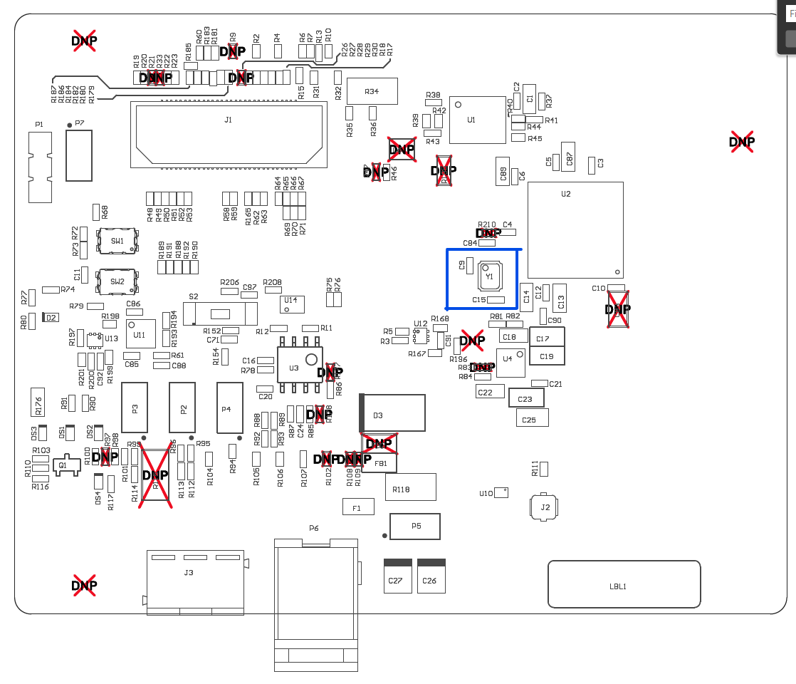

I have 3 AWR1642s connected in a network. They are hardware synchronized (time), but I am looking to synchronize their internal clocks (frequency) with an external 40 MHz signal.
I cannot find where in either J5 or J6 to input both this 40 MHz signal (CLK P pin) as well as the ground signal (CLK M pin) in the AWR1642. Additionally, I have a TI DCA1000 connected to the AWR1642 so I cannot use the J1 pin connectors.
Below is the chart of J5 and J6 options to input the signals:
Thank you!
