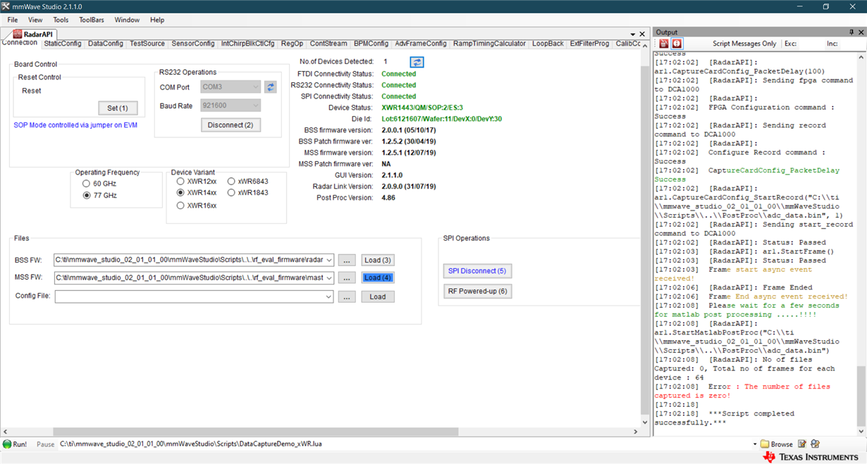

I start the "DataCaptureDemo_xWR.lua" script and everything goes fine until the last part which is capturing data from DCA1000EVM to PC using Ethernet. Here is my log file:

[17:02:08] [RadarAPI]: No of files Captured: 0, Total no of frames for each device : 64
[17:02:08] Error : The number of files captured is zero!
[17:02:18]
[17:02:18] ***Script completed successfully.***

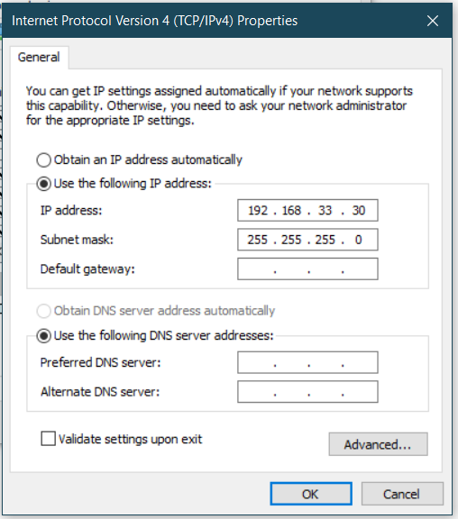

No data is captured. I monitored packets that were transferred through the Ethernet port using Wireshark:
By the time that those 3 highlighted red packets appear on the screen, DATA_TRAN_PRG LED which was on before, turns off for a very brief instant and LVDS_PATH_ERR LED blinks for a an instant:
Here are my other settings and set up, I also attached the Wireshark log file.
dca1000evm_eth.rar
Thank you in advance!

  • So in your case,  there no error, but the raw data captured file is empty.   You can try to increase the Packet Delay setting in the DCA1000 configuration, change from default 25us to 50us or 75us or more.
    Zigang
  • I tried that since it was mentioned in other topics. It was set to 100us (I also tried more, up to 300us) as it can be seen in my log file but no luck; and the host PC is also capable so I don't think this is the issue.
    I also tried to capture data manually without the script but here is the result from the log file:
    Fri Jun 05 13:18:41 2020
    Start Record Command (req)
    Start Record command : Success
    Return status : 0
    Fri Jun 05 13:19:11 2020
    No LVDS data
    Record stop is done successfully
    There is no adc.bin data either. I read in another topic that the FPGA on DCA1000EVM got a 30 seconds time out duration to capture the LVDS data from the radar and when it can't capture it, it triggers the LED_PATH_ERR LED (exactly what happens here) so I suspect the problem might be hardware related maybe? something related to the radar evaluation board or the SAMTEC ribbon cable? is that logical?
    The radar evaluation modules works flawlessly in functional mode and with mmWave Demo Visualizer when the demo is flashed onto its QSPI flash.
  • The design team suggested to add some RSTD.Sleep(2000) before the frame start. Here is the reply from our design team:
    After issuing the DCA1000 ARM command  - ar1.CaptureCardConfig_StartRecord(adc_data_path, 1)
    It is always recommended to wait for 1-2 secs before issuing the StartFrame command. Because the DCA1000 ARM command does not go to the AWR device, instead it goes to the DCA1000 hardware.
    So you to have manage it asynchronously. (That’s why we have the buffer time of 1-2 secs).
    Eg:
    RSTD.Sleep(2000)
    ar1.StartFrame()
