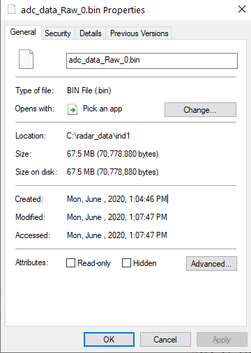

    Yes. I have checked the raw data file and it contains all the frames. It seems to me that the data capture is in real-time only between DCA1000 and IWR1443, but not between DCA1000 and the host PC.

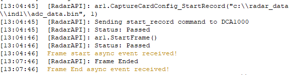

    I did another validation of my view. Here, I have 180 frames with periodicity of 1000ms. So the data capture time should be around 180s.
    I will anticipate each frame will be streamed to the host PC every one sec. However, here is what happened:
    I was keep checking the size of the saved file in Matlab using fopen, fseek and ftell. But, it turned out that the file size is always 0KB at the first 2+mins. And the data streaming only happened when the mmWaveStudio printed a msg "Frame End async event received!", which is almost 3mins after starting capture of the 1st frame!
    As far as I am concerned, "real-time" data capture should happen between the radar and the host PC. For example, I will be able to see one frame coming to the host PC every one second after I send the cmd "ar1.StartFrame()".

    The data streaming is coming to the DCA1000.  But DCA1000 capture application holds the data file and release the data file until the end of the capture.   So, we do not have a way to read the data in the middle of the capture.
    This limitation is part of the DCA1000 DLL library.   We do not have a demo to achieve real-time streaming and access the data file before the end of the data capture due to this limitation.   This DCA1000 DLL source code is also provided with radar studio release, located at: C:\ti\mmwave_studio_02_01_01_00\mmWaveStudio\ReferenceCode\DCA1000
