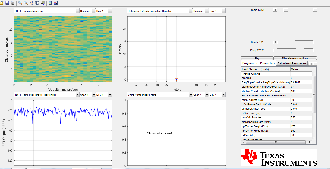

    It almost works now. However i have the following problems
    the data that it is gathered, it doesn't show anything most of the time, in PostProc , distance to velocity.
    we have attemted to move around with different velocity but it doesn't show.

  • Nilo,
    Please keep in mind that when you only use a single RX antenna, you will not be able to extract range-angle information. You need at least 2 RX antennas to determine angle information. With only 1 RX enabled, all you can extract is range information. Without additional RX antennas, you have no way of comparing the differences in phase between the RX antennas. This will help you calculate angle information. This is why your range-angle plot appears empty. If you look at just your 1D FFT output plot, then you can extract information.
    And depending on the scheme you want to use, you can either have each TX transmit independently in TDM-MIMO fashion or have the TX antennas transmit simultaneously. Each scheme offers different benefits. More information is available in our TI whitepapers or other resources online.
    Kyle

    Is that also why 2D FFT amplitude shows nothing?
    I found the following note but i was wondering how to set the chirp phase in mmwave studio?
    Many thanks,
    Nilo
  • Nilo,
    The phase shifter settings are controlled in the "BPMConfig" tab of mmWave Studio.
    Kyle
