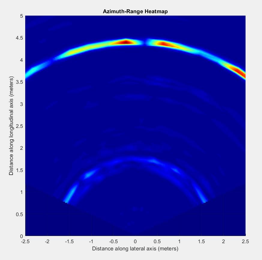

I am using AWR2243 MMWCAS-RF-EVM/MMWCAS-DSP-EVM with processor sdk for radar v3.8. I put one corner reflector in boresight of the cascaded EVM and ran the default TXBF demo and got below result. I saw 3 highlight red points below, instead of one. (MIMO case is working correctly)
The problem was asked in May and closed as there would be a new software release. I'd like to know when the software will release?
How can I fix the azimuth range issue now ? I tried to change txPhaseMismatch in "chains_common_cascade_ar12xx_config_bf.c" and phaseCalibVectorRxAntenna in "chains_cascadeRadarBf.c", but still don't get the good result.

  • Hi Wei03,
    Please see the attached draft of the Cascade TX phase shifter calibration example which will be released in the next mmWave Studio release. This shows a general TX phase shifter calibration flow as well as example mmWave Studio scripts to be run with the MMWCAS-RF-EVM and Matlab. This flow will provide the TX calibration data you need for setting up a calibrated TX beam-forming/steering example. However, additional work will still be needed to port that into the TDA2 Processors SDK radar TX-BF example.

  • Hi Randy,
    No, because idxTX index is out of calData boundary. The script prompts error.
    I tried "AWRx_TX_Phase_Cal_Scripts_20200309_rev3" scripts with mmWave studio 2.1.0.0 and AWR2243 cascade EVM, it could generate the TX Phase Shifter lookup table. Then I use TX calibration data(calibrateTXPhaseResult.mat) along with MIMO calibration data(calibrateResults_high.mat) to do TXBF, but the output still doesn't match with real world.
    Could you see anything error in the following steps?
    1. get calibration data
    1.1.  run Cascade_Phase_Shifter_Calibration_AWRx.lua with a single corner reflector target placed at boresight 5 meters away in a microwave chamber
    1.2.  run cascade_TX_Phase_Calibration.m to create "calibrateTXPhaseResult.mat"
    1.3.  run Cascade_COnfiguration_MIMO.lua,Cascade_Capture.lua and cascade_MIMO_antennaCalib.m to create "calibrateResults_high.mat"
    2. capture data with calibration data
    2.1. run “Cascade_Basic_Configuration.lua”
    2.2  edit phaseShiftCalibfile and phaseMismatchCalibfile in “cascade_TxBF_dataCapture.m” and run
    2.3. run “Cascade_Capture.lua” and copy to pc
    2.4. run "cascade_TxBF_signalprocessing.m" to see the result

  • Hi Wei03,
    The process you are outlining looks roughly correct, but I would still recommend following the whole procedure I outlined. In my rev4 release there is also a set of mmWave Studio Lua scripts and Matlab scripts for verifying that the TX phase shifter calibration was effective, by setting up a simple TX-BF example configuration with and without the calibration data applied. Have you given that a try as well?
    Also, are you saying that you used the phase offset data in the calibrateTXPhaseResult.mat directly? Or did you do the necessary, additional processing on this data to convert it into a beam-angle vs. phase shifter programming lookup table as I did in my examples?
    The rev3 version of that TX phase cal tool had a few problems and calibration data capture took too long. That is why I posted the rev4 version. However, rev4 was only tested with mmWave Studio 3.0.0.7 and DFP 2.1.5.3.

  • Hi Randy,
    I tested AWRx_TX_Phase_Cal_Scripts_20200811_rev4.zip in a mmwave chamber, but the result is not expected like the doc.
    When running Cascade_Phase_Shifter_Calibration_AWRx.lua, it occurs error. The complete 64 phase is complete in 3 times by changing the phase start index.
    Then LUT generated as follows, it looks abnormal. The data in red is not close to zero phase.
    0,6,37,32,34,3,59,63,29
    0,8,42,35,42,13,7,14,50
    0,10,47,42,52,24,20,27,2
    0,12,52,50,60,35,34,45,20
    0,14,56,56,5,46,46,60,36
    0,17,60,63,14,58,60,11,55
    0,19,1,5,22,4,9,25,8
    0,21,5,11,28,15,22,41,25
    0,22,9,18,40,25,35,58,43
    0,24,13,24,50,39,50,9,62
    0,26,18,29,58,50,62,24,15
    0,32,22,38,3,60,11,40,34
    0,30,26,45,12,7,24,56,51
    0,34,30,52,21,18,38,8,5
    0,35,35,59,32,32,52,22,22
    0,0,0,0,0,0,0,0,0
    0,40,46,8,47,52,14,54,59
    0,42,50,14,57,63,27,6,12
    0,46,54,21,2,10,41,21,32
    0,47,59,26,10,21,55,36,49
    0,51,63,35,19,33,4,53,2
    0,52,3,41,27,44,17,5,19
    0,54,8,49,36,55,32,20,36
    0,57,12,55,46,1,43,35,55
    0,59,17,62,55,12,58,51,8
    0,61,21,4,63,23,6,2,25
    0,63,25,10,9,35,19,18,45
    0,2,32,17,18,46,34,34,62
    0,4,34,23,25,57,46,49,15
    0,6,37,32,35,3,59,63,33
    0,8,42,35,42,14,8,15,50
    After modify LUT and run Cascade_Configuration_TXBF_AngleSweep.lua script, the uncalibrated and calibrated beam angle looks the same.
