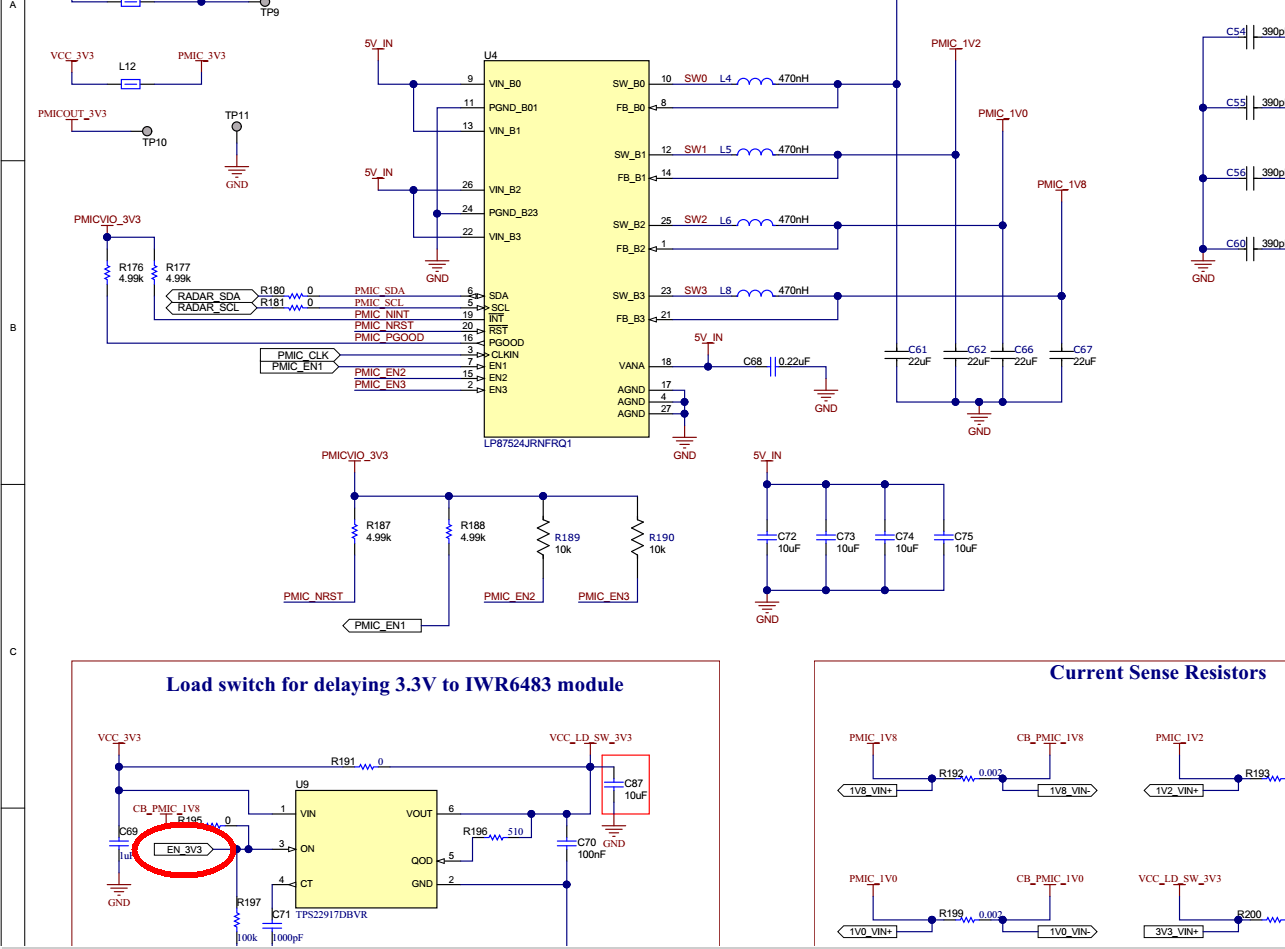

I find there is a TPS22917DBVR used on IWR6843ISK-ODS EVM board, I wonder what the function is for IWR6843 based application?  why does the system need a "Load switch for delaying 3.3V ".
Is there more information for this requirement available?
    Please see section 5.10.1 of datasheet. The TPS22917DBVR is to ensure the 3V3 is delayed until other rails are provided to meet the timing requirment

    Yes, I have studied the IWR6843 datasheet section 5.10.1, the VIOIN is the 3.3V power rail. I believe that TI IWR series sensors would have the similar chip design, so the external power solution may be similar. I designed a project based on iwr1443 and took the sprr254 EVM as a reference. There was a same power sequence requirement in 5.9.1 Power Supply Sequencing and Reset Timing of  iwr1443's datasheet. however there was no a TPS22917 used to generate the 3.3V volatage to VIOIN of IWR1443. On this IWR1443 EVM (PROC010B(003)_Sch), VIOIN is supplied by PMIC 3.3V output through a 0 ohm resistor, the power sequence can not be controlled. So I wonder whether this requirement for is strict for IWR6843 application?  I want to remove this device to reduce the BOM cost, is it OK?
  • Hi

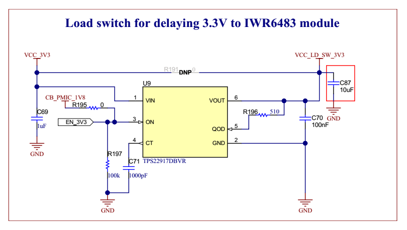

    Furthermore, the net EN_3V3 in above screen snapshot is a siingle net in SCH PROC075C(001_IWR)_Sch (swrr165) .  please help to confirm if this is a mistake? who will control the EN_3V3.
    This net is also connected to the PMIC PG(GPO1)
    Charles O
  • Hi
    I double check this connection, I can't find the net in PMIC portion(swrr165 RevC and RevD). It looks CB_PMIC_1V8 are used to enable the TPS22917DBVR .
    Please help double check which one is correct? Must I connect the EN_3V3 to PMIC PG(GPO1)? If so I must modify my design.
    Cunhui
  • HI
    What about these questions?
    if you are using the LP87524 PMIC with the 5V input and 3V3 as one of the output, the timing should/can be set with the PMIC.  The TPS22917 redundancy is not needed.
