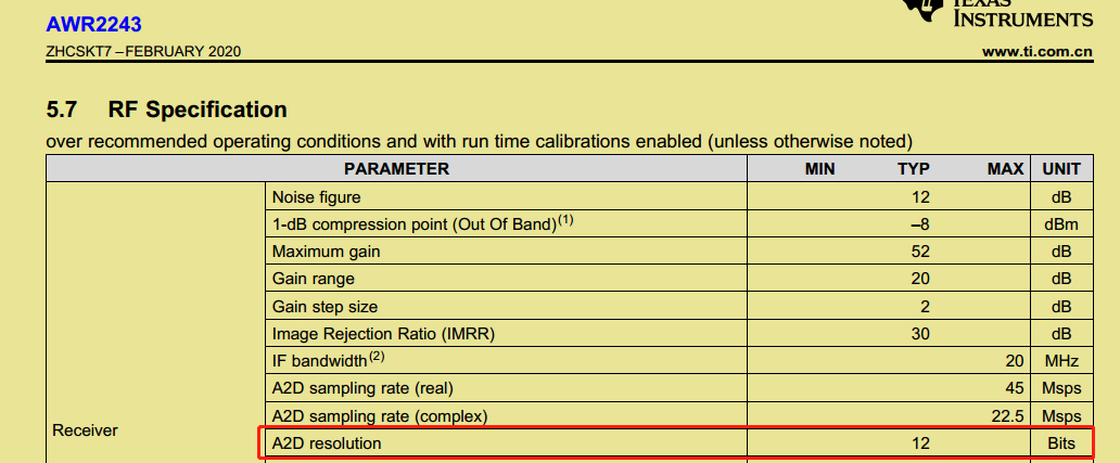

 I see the datasheet of AWR2243 in page 20,the ADC resolution is 12bit,

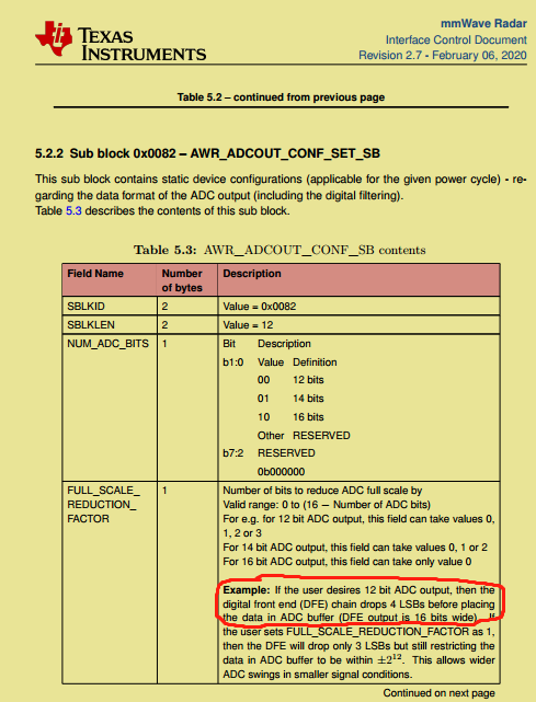

but I see in the "mmWave Radar Interface Control Document" ,as follows, the ADC output can set 16bit , and it also mentioned that “If the user desires 12 bit ADC output, then the
digital front end (DFE) chain drops 4 LSBs before placingthe data in ADC buffer(DFE output is 16 bits wide)” it means the ADC is 16bit resolution, How is the conversion from 12bit to 16bit? Is there any specific conversion formula,thanks.
