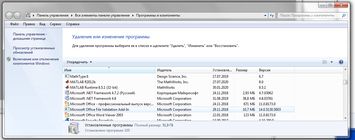

God day, Cesar
I am using the 2.01.01 version, I believe it's the latest. Had this error on two different machines,
one with windows 7, another with windows 10
Michael,
Please make sure that you have MATLAB runtime v8.5.1 (32-bit) installed on your PC. You must use the 32-bit version of the runtime and not the 64-bit version.
Kyle
Michael,
Please make sure that the MATLAB v8.5.1 (32-bit) runtime directory is the has the highest priority of any other MATLAB installations in the Windows "PATH" environment variable.
You can also try deleting the entire RSTD folder located at
C:\Users\<username>\AppData\Roaming
Kyle
