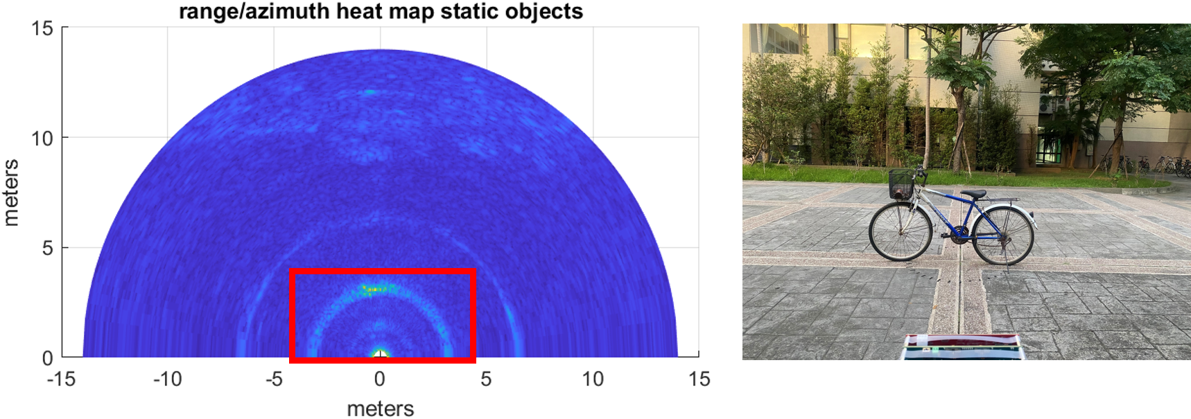

Hi, I used the AWR2243 cascade radar to capture raw data of the bike in MIMO mode.
The LUA scripts I used are "Cascade_Capture.lua" and "Cascade_Configuration_MIMO.lua" in mmWave Studio 03.00.00.07.
After post-processing with "cascade_MIMO_signalProcessing", there is a obvious circle shape near the object on the RA heat map. (as figure below)
Why does it happen and can we eliminate the circle shape? how?
Thank you for your help.
    That is the Tx antenna to Rx antenna coupling showing up close to setup.
    You need to calibrate the device, mmwave Studio Matlab script provide the script and user guide explains the steps
    4chip_cascade_MIMO_example\modules\calibration
    Jitendra

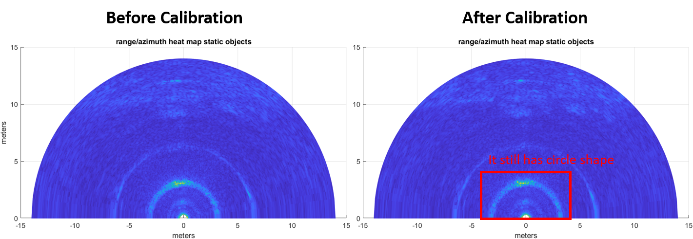

  • Hi, Jitendra
    According to 8.3.2.2 Calibration section in the cascade user guide, I have calibrated the device with a corner reflector at 5 meter.
    After post-processing, it still has circle shape on the RA heat map.
    Is there another way to eliminate the circle shape?

  • Hi user6346307,
    There are two primary issues which might be at play here.
    1) Our example Matlab angle FFT function currently does use any windowing. Adding windowing may help keep these angle FFT side-lobes down.
    2) If you can plot the angle FFT separately for this target? After a good calibration you should see about 13dB offset from the peak to the side-lobes. If you see less separation than that, the initial phase calibration might need to be redone to get a more accurate calibration. Because there is little difference in the before and after calibration results, I suspect this might be the case. Can you take a look at the output graphs from the calibration scripts and post it here?
