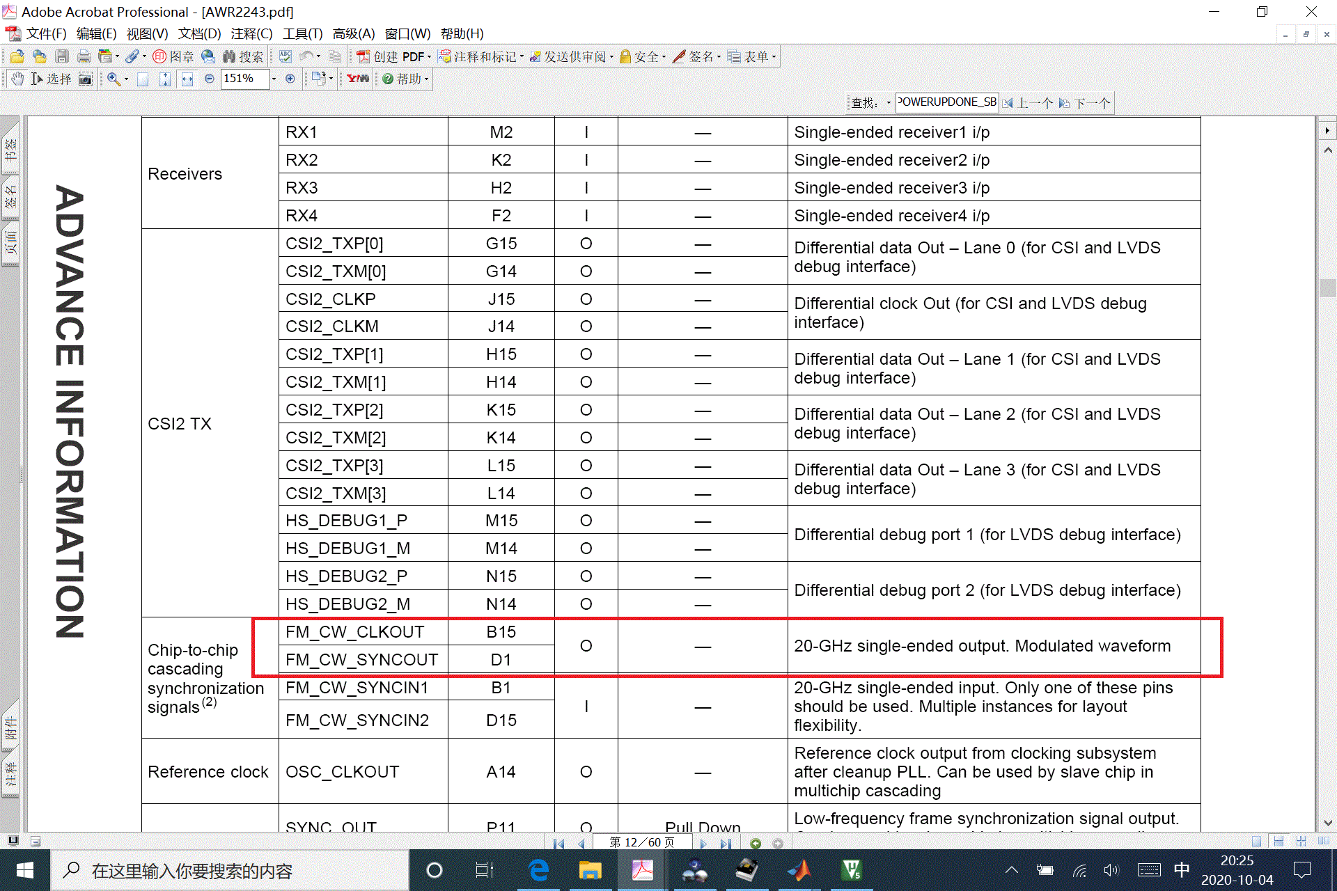

    >>another question: demo is 4 pcs AWR2243 cascaded, the 20G FWCW SYNC output from master is two output: one is for master/slave, another is for two slave >>based on Wilkenson Power Divider, if my image radar needs more TX/RX(that means the chips I need is more than 4 pcs), how can I use 20G FWCW SYNC? it >>only 2 output.
    More more the 4 chip cascading you can use an onboard amplifier of the 20Ghz signal and then have larger number of dividers (either a 1:4 divider or two cascaded 1:2 dividers) to derive signal for more chips. You just need to take care that the path delays are matched to all the chips.

       1. More more the 4 chip cascading you can use an onboard amplifier of the 20Ghz signal and then have larger number of dividers (either a 1:4 divider or two cascaded 1:2 dividers) to derive signal for more chips. You just need to take care that the path delays are matched to all the chips.
        -----onboard amplifier, I don't find this amplifier from schematic released in TI website for cascaded solution. could you give more detailed information, it is one chip or integrated by AWR2243?

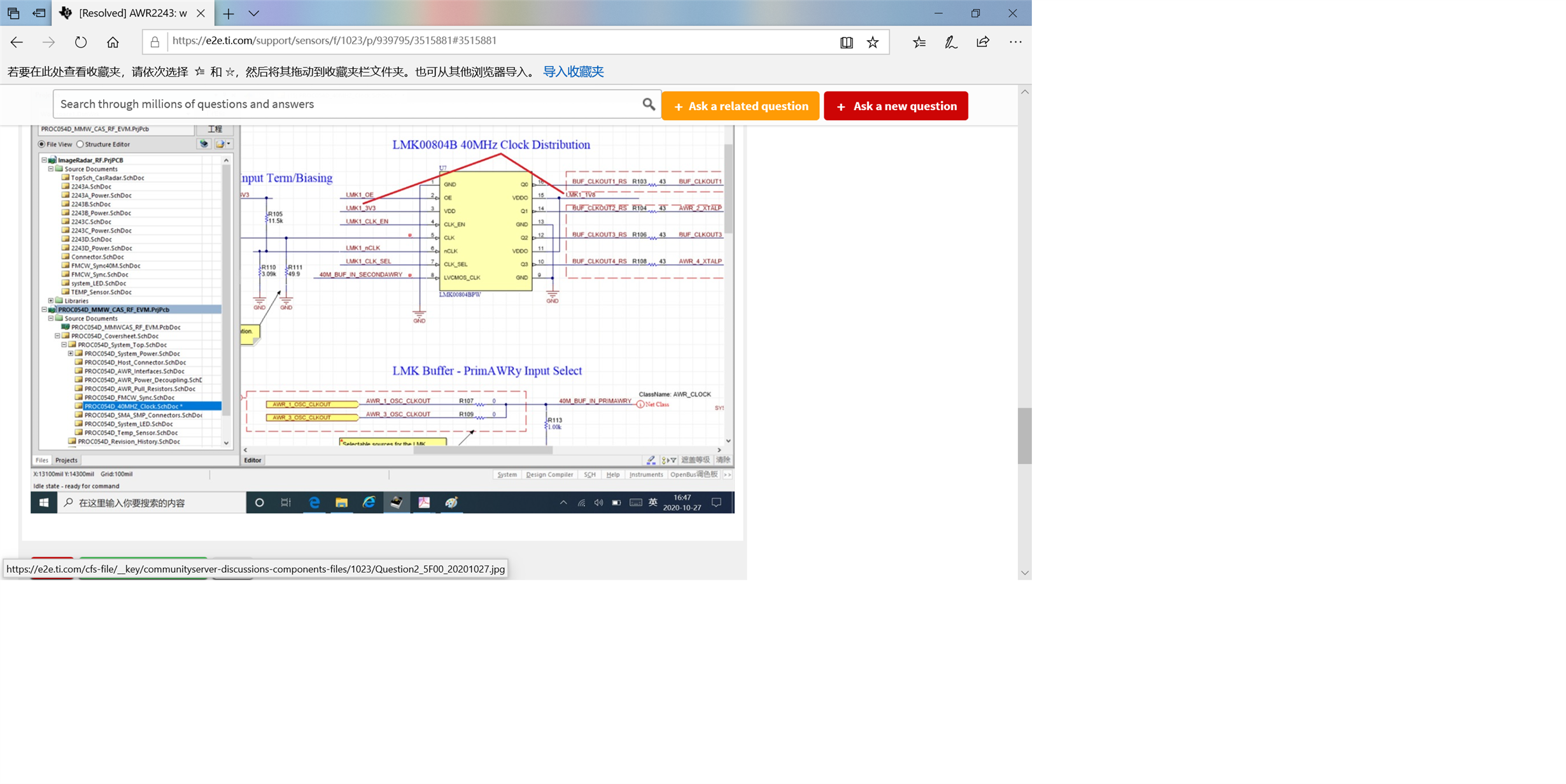

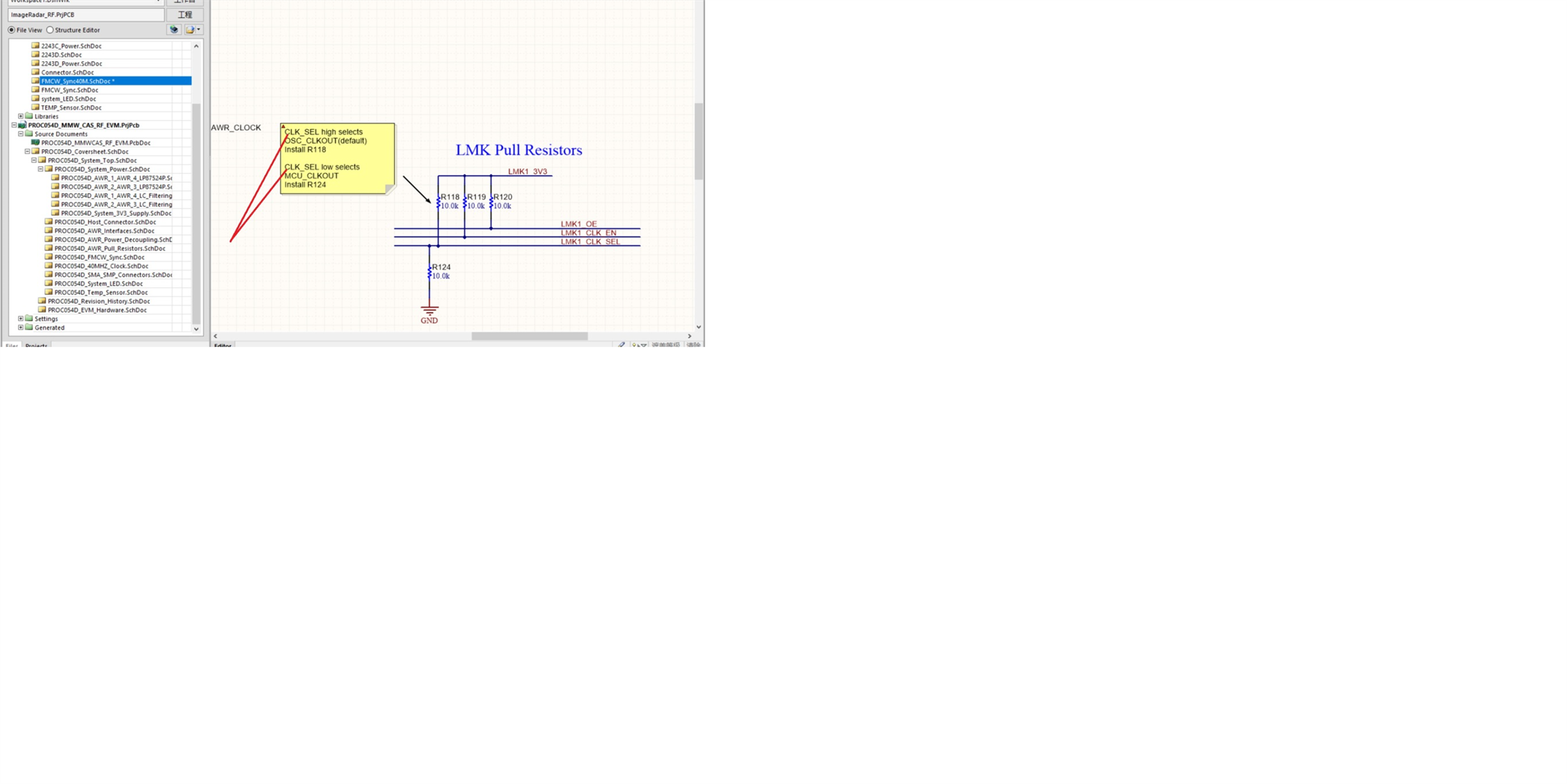

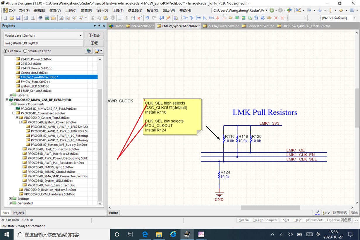

       I am designing Cascaded radar(4 pcs AWR2243) schematic now, confirm one thing: for 40M clk, I prepare to use LMK00804B as 40M clk buffer of slave chips as reference design of TI , for LMK00804B, input clk is from A14(PIN) of master, another N9 pin(MCU_CLKOUT) is for FPGA.
        When I read schematic of TI reference design---tidm464, it gives: clk_sel  “1”  OSC_CLKOUT  “0”   MCU_CLKOUT. clk_sel is pin7 of LMK00804B, it should be used for choose single input clk or differential input clk. from my understanding OSC_CLKOUT and  MCU_CLKOUT both single clk. if my understanding is right, then schematic of tidm464 gives wrong information, is it right?(you can see attachments- it is part of tidm464.lists below)
        additionally, from datasheet, my understanding is : if master chips use 40M OSC, then OSC_CLKOUT is 40M.
    MCU_CLKOUT from datasheet is programmable, it can be set through reg and gives different clk output frequency? is it right?

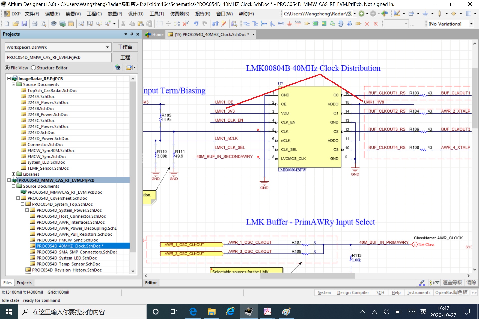

      miss one:  2243 IO voltage is 3.3V, LMK00804B VDDO support 3.3V,too! if I use one mater chips to supply 40M to other 3 slave chips, why not both VDDO/VDD supply 3.3V, I find tidm464 VDD is 3.3V  VDDO 1.8V?

  • Hello Zheng,
    For cascading purpose we use OSC CLKOUT signal and not MCU CLKOUT since OSC CLKOUT is analog signal and has lower jitter/phase noise.
    This signal is 1.4V level and that is why we have used the differential input of the  LMK00804B buffer by biasing  the CLKm pin at mid point (0.7V).
    The VDDO is set to 1.8V since the CLKp can take max of 1.8V input level.

  • Hello Vivek,
       could I use OSC CLKOUT as input LVCOMS_CLK(pin8) of  LMK00804B? in tidm464, input LVCOMS_CLK(pin8) of  LMK00804B is MCU CLKOUT.
  • Hello Zheng,
    The OSC CLKOUT is a 1.4V level signal, so it cannot be used for the LV CMOS input of the LMK buffer since that expects a 3.3V signal level. You need to use the Clk p input of the LMK00804B buffer as used in the TIDEP-01012 (https://www.ti.com/tool/TIDEP-01012

  • Hello Vivek,
       thanks for you quick response!
      I find SYNC_OUT(P11 PIN of AWR2243) connect LVCOMS input of LMK00804B in tidm464,, that means SYNC_OUT output is 3.3V , but OSC CLKOUT is a 1.4V, is right?the datasheet of AWR2243 don't write it clearly here.
  • Hello Zheng,
    You are right, the SYNC_OUT is digital signal and hence at 3.3V IO level. OSC CLKOUT is an analog signal and 1.4V level.
