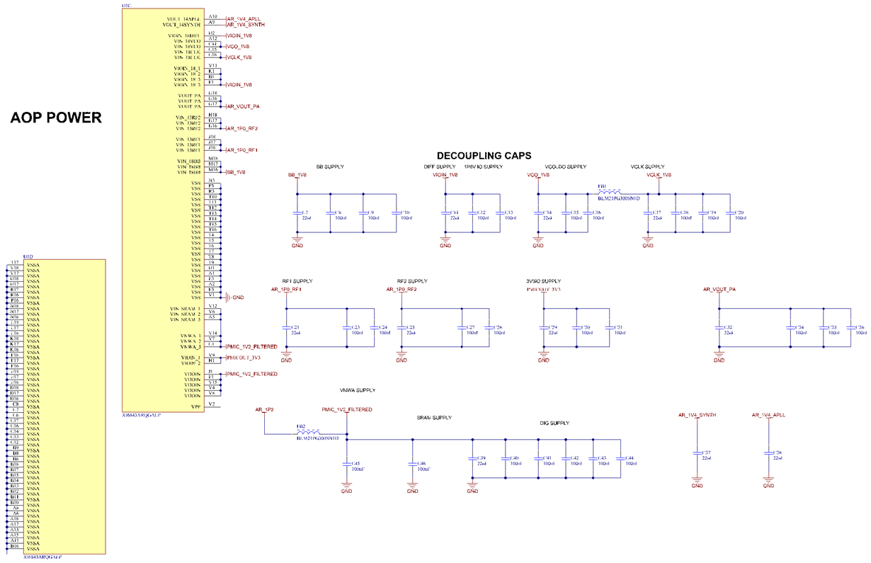

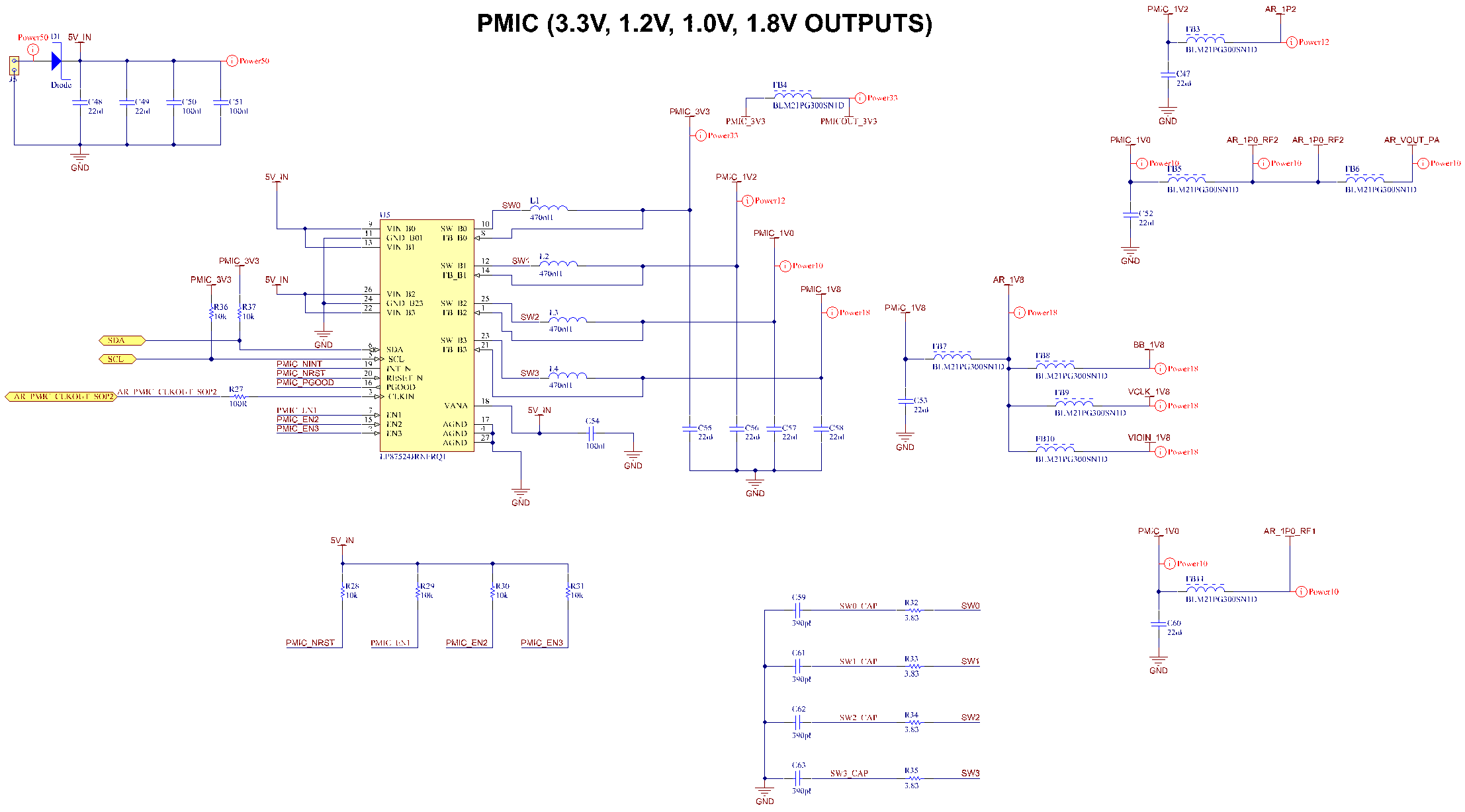

    attached I send you the PDF schematics.
    TI Radar integrated Antenna.PDF
    I reviewed the schematic, there is not a lot that needs to change.
    1. VBGAP (A16) should be 47nF, this is an update from 22nF used in the current schematic reference. You 100nF in your schematic, this is not recommended.
    2. Ensure the LVDS trace meet the 100ohms differential impedance recommendations. Also note that this is high speed lines.
    3. Ensure RC timing is such that SOP lines ramp up to steady state before NReset crosses 1.5V

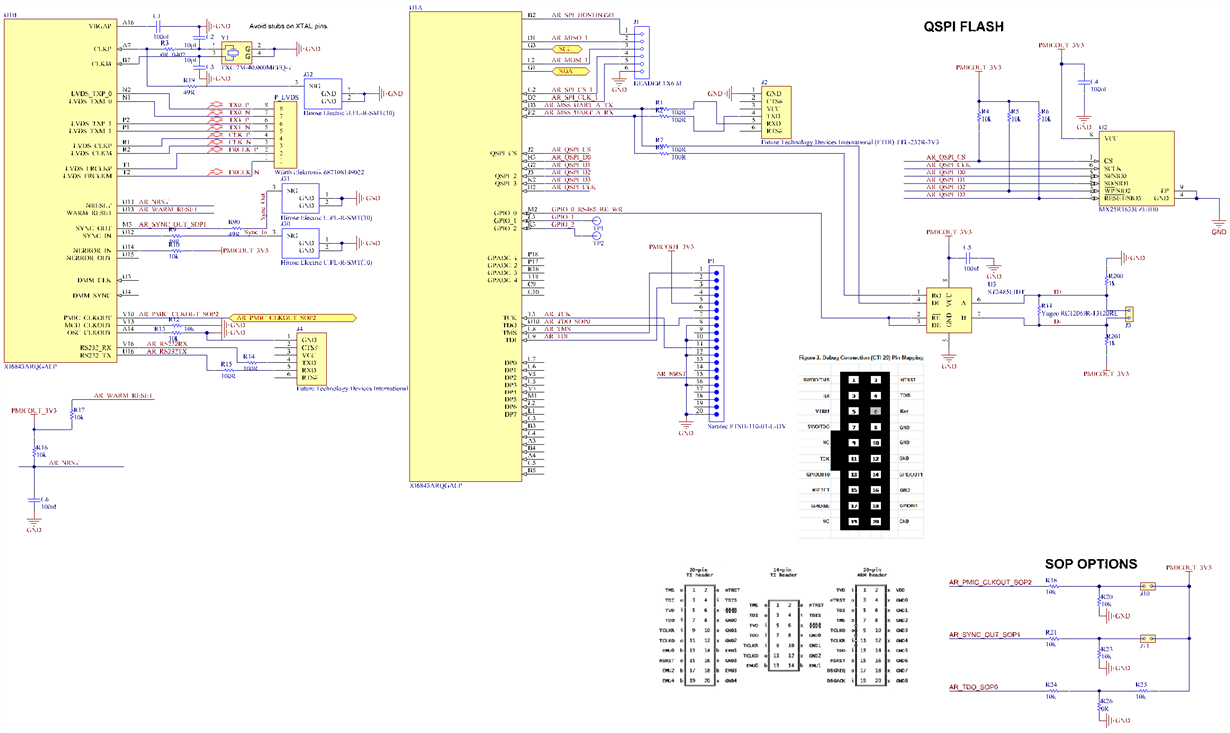

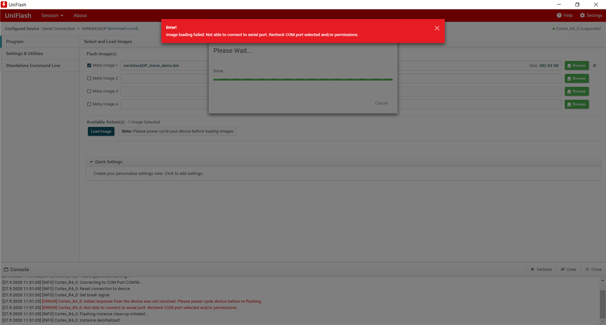

    HW Configuration:
    I connect a FTDI Cable (3.3V version) to the Connector J4
    SOP2 = 1 (high)
    SOP1 = 0 (Low)
    SOP0 = 1 (high)

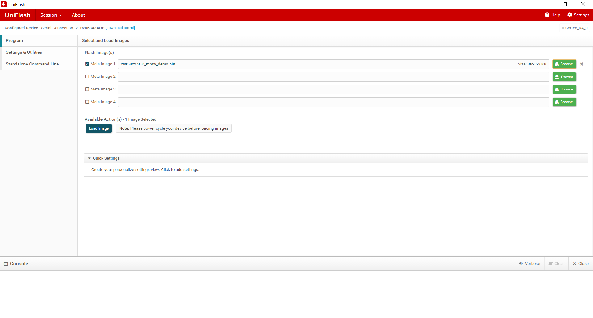

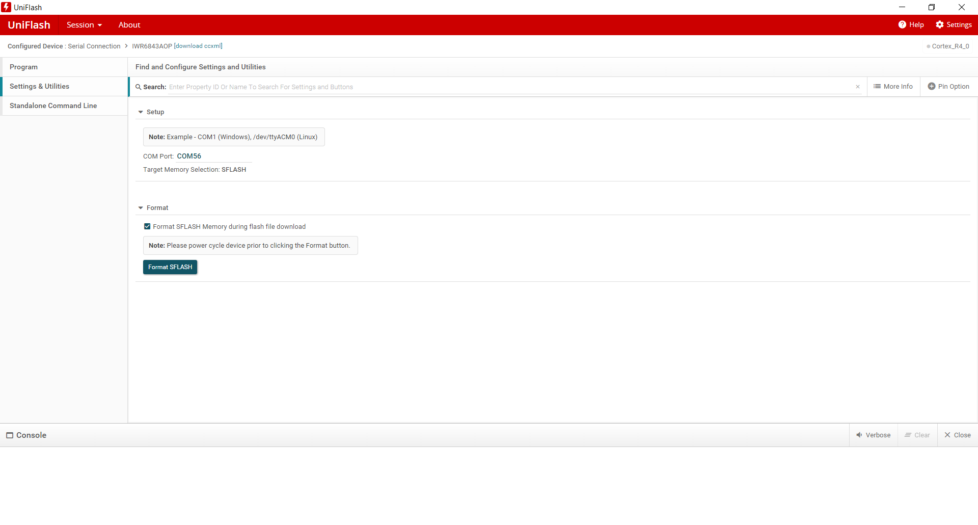

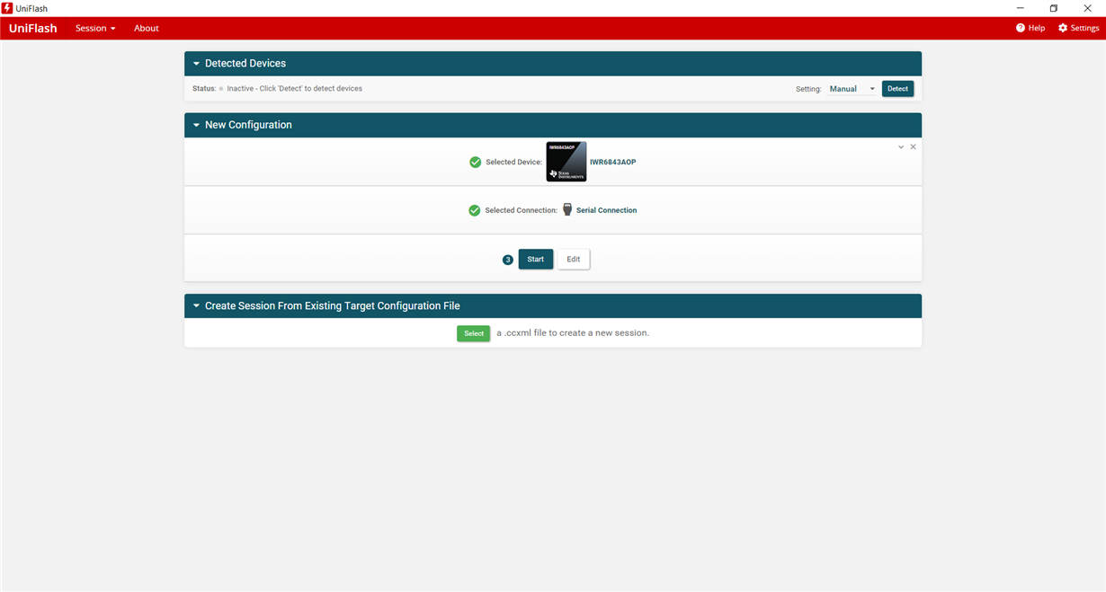

    SW Configuration:
    To program the device I use the UniFlash 6.1.0.
    After pressing Start the following screen appears.
    I have selected the image C:\ti\mmwave_industrial_toolbox_4_3_2\labs\out_of_box_demo\68xx_aop_mmwave_sdk_hwa\prebuilt_binaries\xwr64xxAOP_mmw_demo.bin
    Then I select the COM Port (COM56) of the connected FTDI Cable
    Then I switched the power supply on.
    After that I go back to Program Screen and press the button Load Image
    Within 20 sec the following screen appears
  • Hello,Michael,
          After the power supply and SOP configuration, it's important to assert a NRESET to register boot mode (Flashing boot mode in this case), Only if the device is in SOP2 mode (Flashing mode then) you would be able to communicate with the device through the Uniflash application.
    Please ensure I/Os are not driven from external interfaces when the VIO supply to the device is not present, i.e. RS232 lines and MSS_logger UART pull up lines. This will cause boot up & reliability problems.
    RS232 UART signal / MSS logger pull up need to be connected to 3.3V VIO supply. And it should not be driven from the external I/O without VIO supply being present on the mmWave sensor board. Otherwise there could be problem by internal protection ESD diode turning on and incorrectly powering the sensor.
    Crystal pins needs only 4.7pf capacitor, 10pf is on the higher side, Also R19 plus long trance + connector adds additional parasitic capacitor. On the crystal pin no other parasitic should be present. Please remove R19. Also position of R19 need to be reviewed in the layout. Could you please post the layout files?
    Are you able to connect to the device through the CCS (Code composer studio)?
    NERROR needs external pull-up. If there is a fault in the system NERROR  would be asserted low. you could Probe this line to identify any fault in the system.
