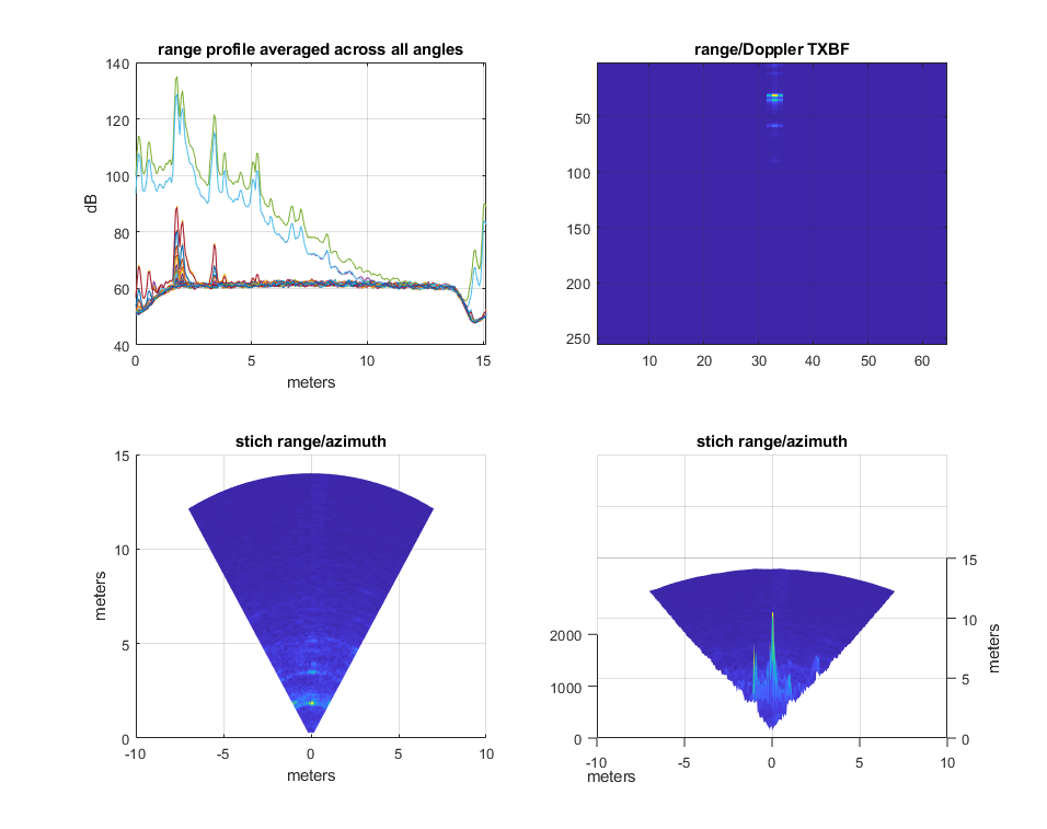

The default scan range is [-15:1:15] in "cascade_TxBF_dataCapture.m" txbf studio demo. If I increase azimuth range or decrease degree slice, the added part of adc values are wrong.
For example, I changed to [-20:1:20]. Then capture data and run "cascade_MIMO_signalProcessing.m".
Many values in adcData1Complex(:, :, :, 32:41) from slave_xx_data.bin are the same which run by "fcn_read_AdvFrmConfig_BF_Json.m". (master_xx_data.bin seems ok)
