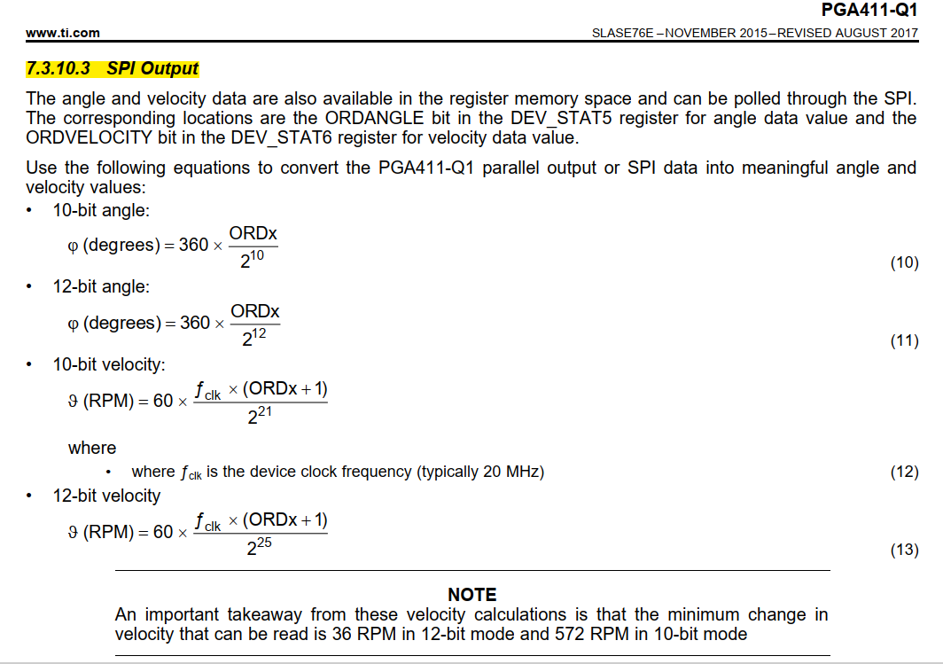

1. What is the minimum RPM that could be read by the resolver? The Datasheet says it is in steps of 36 RPM in 12-bit resolution. With PGA411-Q1EVM, I'm able to get in steps of 35 RPM.
2. I've read in other forum that it could be 2 RPM, how could that be achieved?
3. I'm aiming for 0.1 RPM for my application. Is it possible with this IC?
