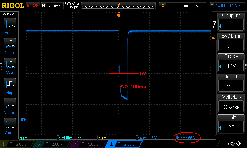

My guess of issue reason is the burst current.
I checked if same register vanishment happens by turning down the power voltage to lower than 6V from 12V slowly but it didn't happen, even though error flags of under voltages and threshold CRC error are stated.
The difference of situation was that I checked it while PGA460 is idle, not bursting.
Then the vanishment is scanned while PGA460 in burst and listen cycle, as I mentioned above. So I guess burst current is causing the vanishment of burst pulses number register values.
It occurres above under voltage, before threshold memory disappears, behind any error flag.

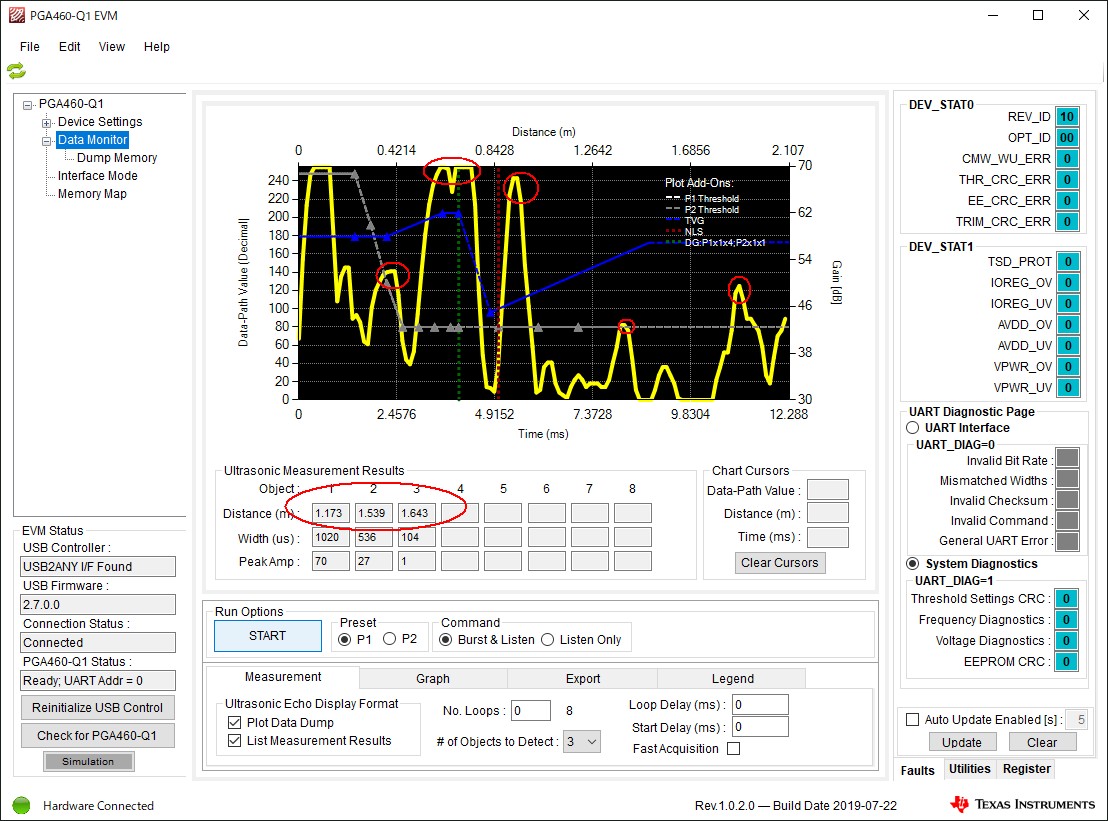

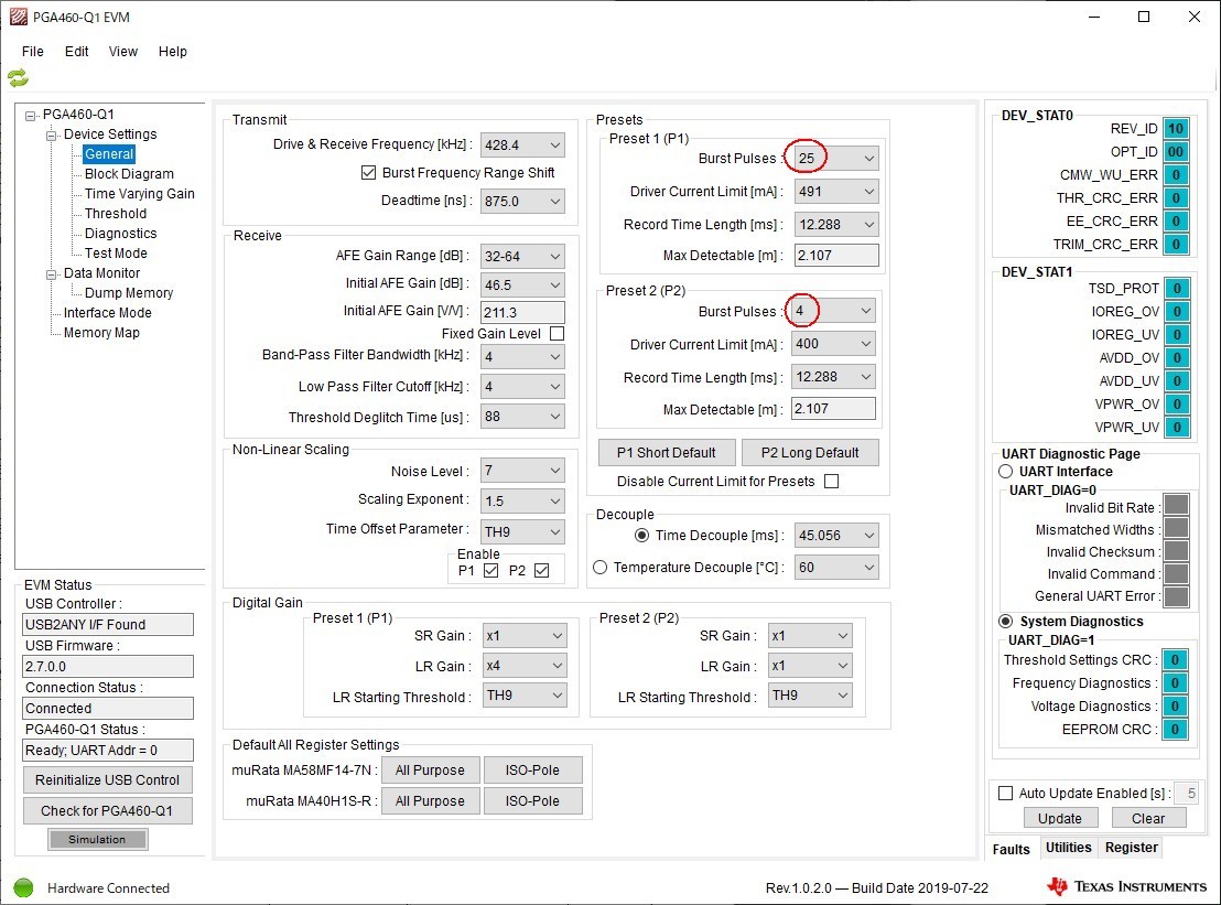

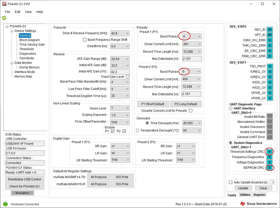

Please trace 3 screen captures.
1st, lost burst numbers and no CRC error alarted:
2nd, original correct settings:
3rd, burst pulses number left random instead of 0 sometimes:
All other values are kept but only burst pules numbers are lost.
Please help.

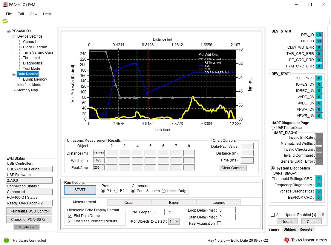

  • Here is more related issue.

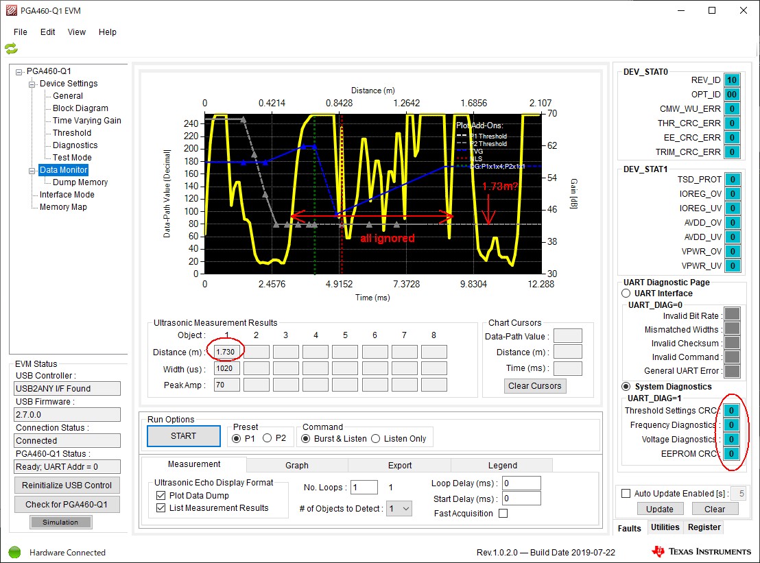

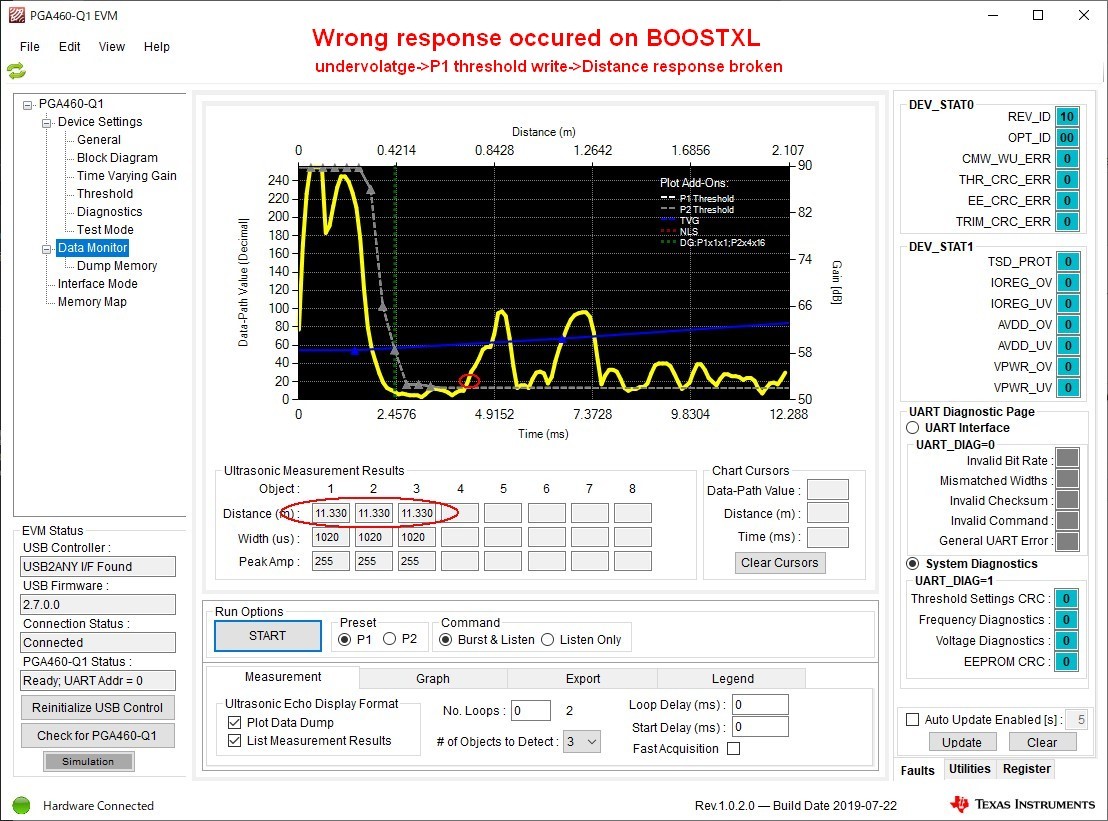

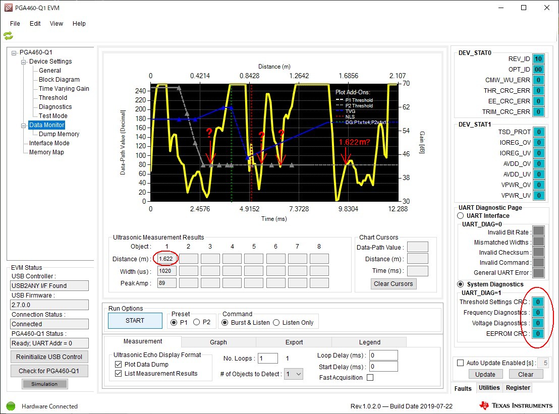

    In same power interrupt inspection, more unnoticeable problem happened.
    While placing the bounce object at 0.5m distance, PGA460 started responding object at 1.6m away and that wrong response kept eternally eventhough no error is stated.
    I guess some internal current or leak voltage breaks the register values randomly not only burst pulses.
    Here's the screenshot of wrong measurement response.
    You can see the wave that swings above the threshold line many times before 1.6m but it reports 1.6m as the first detection.
    Screenshot below tells all ignored but unexisting object reported:

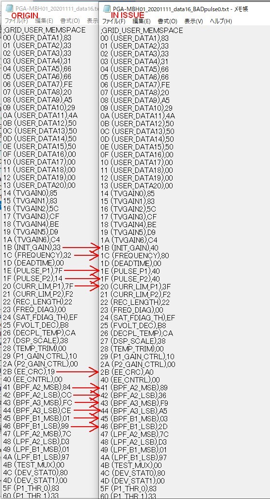

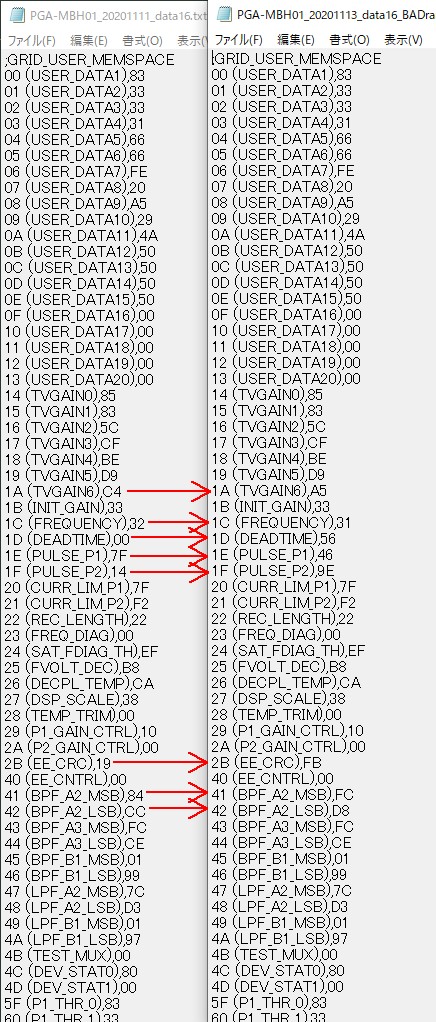

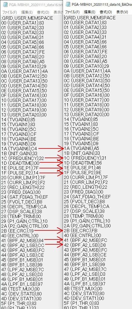

  • I saved the memory map from troubling PGA460 and traced with original map.
    There was no difference in them.
    So the problem might be in working registers.

  • Hi Mekre,
    Step1. After you observe this issue, could you go to the “Memory Map” screen on the GUI and Click the “Read All” button? After doing this, do you see the the P1 and P2 pulse values return back to normal when you look back at the “General” screen again?
    Ans1. No, both P1 and P2 pulse values kept 0 in the "General" screen. I clicked "Check for PGA460-Q1" then "Read All" so the Memory Map is really read from physical PGA460 to GUI and it showed 0 burst pulses.
    Step2. If not, do you also see that the values of the “Pulse_P1” and “Pulse_P2” registers in the “Memory Map” screen are also wrong?
    Ans2. Memory map also shows wrong pulse values such as PULSE_P1 01000000, PULSE_P2 01000000.
    Step3. Also, after you see this issue, can you try removing power to the board for a couple of seconds and then powering it up back again? After doing this, do you see that the pulse values return back to normal?
    Ans3. Yes, pulse values return back to normal. So values in EEPROM is not affected but values in registers are over written random.

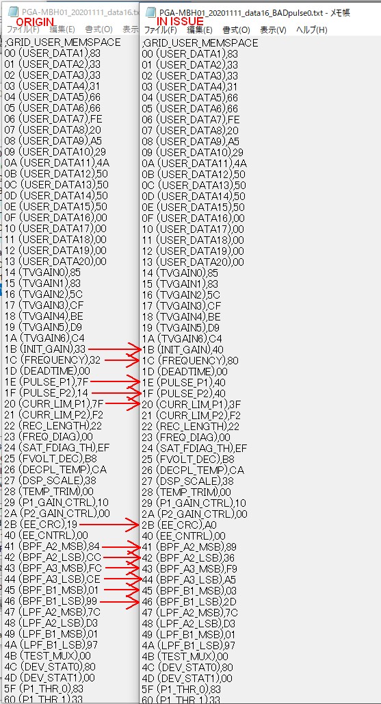

  • Here's memory map trace of the PGA460 in issue, burst pulse values turned to 0, and origin.
    It tells values are overwitten not only burst pulse but also gain, frequency, EE_CRC and BPF.
    Interesting point is EE_CRC changed. I guess it is generated by PGA460 core.

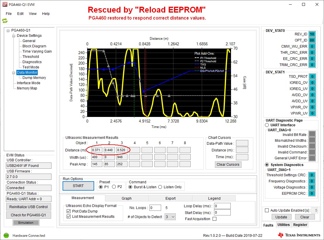

  • Mekre, thanks but the result I see through GUI is suspicious...
    I followed your GUI reload eeprom method to the issued PGA460 which memory is as below:
    I did "Check for PGA460-Q1", "Read All", "Reload EEPROM", "Read All" then memory map showed all "00". It is very strange.
    Then I did it 1 more time "Reload EEPROM", "Read All". It showed seemingly correct values in memory map.
    And I went to Data Monitor to see if it really function. Surprisingly, record length became wrong, infact REC_LENGTH register had not bad value before reloading as above memory map tells.
    Then I clicked "Reload EEPROM" again. Then it functioned correctly finally.

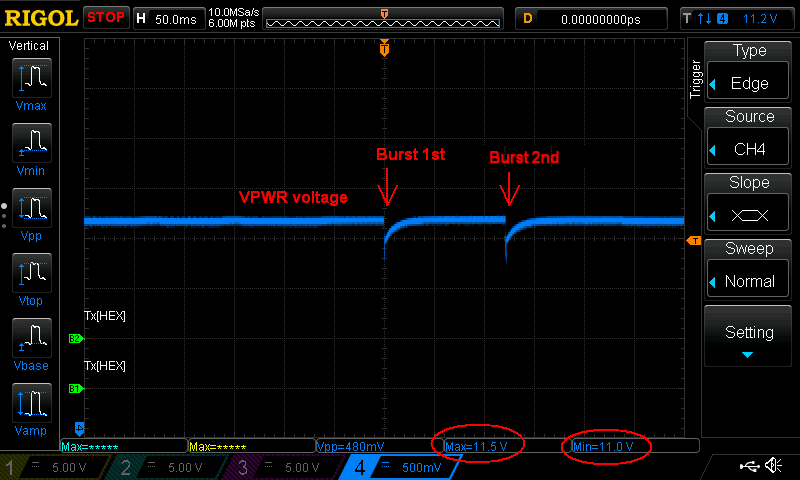

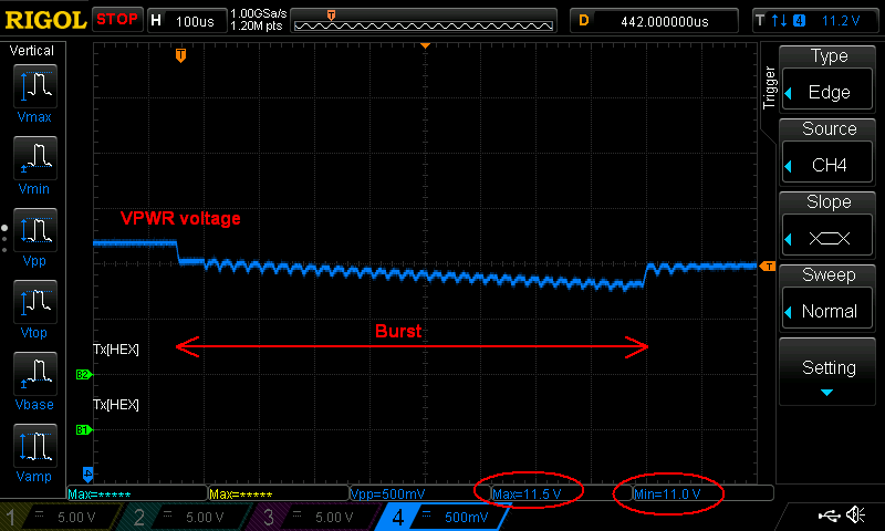

  • Here's my circuit. The power source is the battery of heavy industry vehicle. The power voltage varies 10V - 30V.
    PGA460relativecircuit.pdf
  • Here's VPWR voltage ripples in normal situation. I think it is not bad.
    Close look.

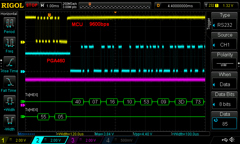

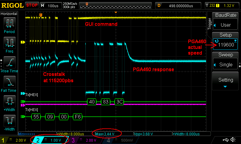

  • About UART signal consistency between LaunchPad and PGA460 on PCB.
    I found there is strong crosstalk appears in GUI communication wire from LaunchPad. But that seems not disturbing the communication. Response signal is clear.
    Here is UART signals between MCU and PGA460.
    I realised diodes, D3 and D4, in two PGA460 response wires are not needed. They just can be tied together. They are pulled up to 3.3v through 100Kohm.
    It seems PGA460 TX port is high impedance at idle, that shields confliction to other PGA460s.
    Andy
  • Hi Andy,
    I see extra connections on your UART TX and UART RX lines that are not present in the PGA460 EVM. Do you see the same issues when you use the PGA460 EVM with the MSP-EXP430F5529LP instead?
    Can you also try removing R11, D3, and D4 on your board to see if it makes a difference? You may have to add an additional connection to make sure that the PGA460 TXD pin is connected to your microcontroller after you remove D3 and D4.
    Mekre

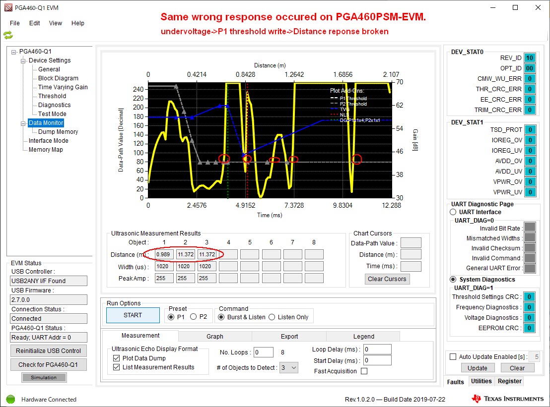

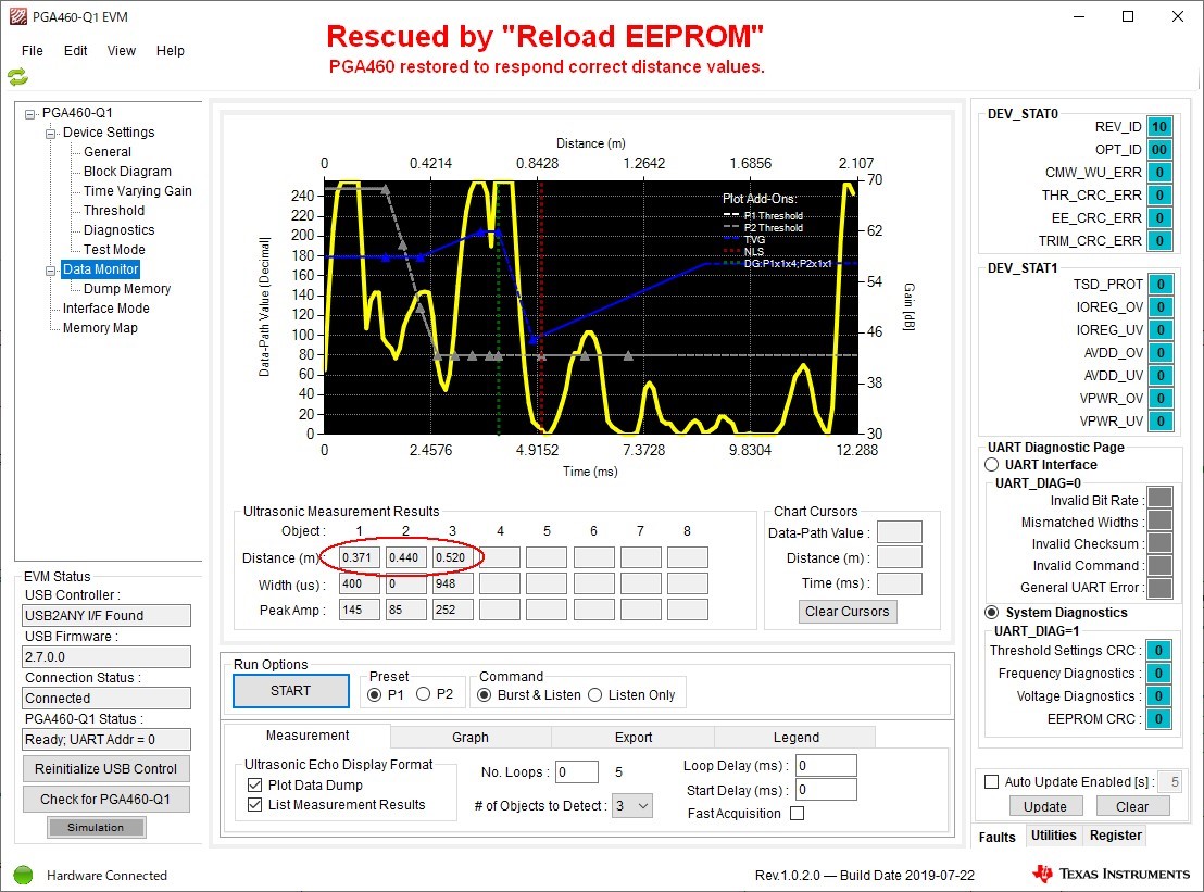

  • I checked PGA460 EVM with MSP-EX430F5529LP and no register overwrite could be found BUT it also starts to respond wrong distances.
    And PGA460PSM-EVM also does same.
    I removed R11, D3 and D4 and PGA460 still remains the problem. It is simply same with EVM.
    I took every memory map of PGA460 EVM in issue and they all had no mis-match to the original map. Now problem is outside of registers.
    Then the problem origin becomes deeper. If problem was in register values, it is visible and can be rescued by reloading it.
    But when it is invisible and untouchable, problem becomes uncontrollable since PGA460 does not have "reset" command.
    Although, "Reload EEPROM" command looks recovering the whole issue, not only registers but also program memories, I am curious if it also reloads program memories.
    As much as I see the distance values of post-issued PGA460 rescued by "Reload EEPROM", distance values are recovered as below.
    In issue.
    Recovered.
    So, for concerning undervoltage or close undervoltage, PGA460 needs "Reload EEPROM" command to every burst&listen cycle.
    I am not sure if the undervoltage flag was set all the time PGA460 derails by low power. Even if undervoltage flag is set, there seems no command to reset whole PGA460.
    Hopefully "Reload EEPROM" recovers all program condition.

  • This is the power interrupt waveform that PGA460 malfunctions.
    It is same on EVM.

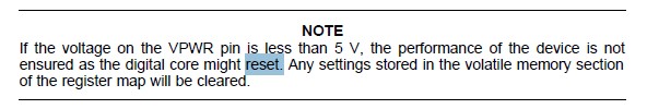

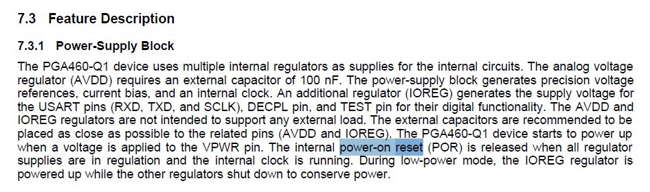

    Problem seems to be "Internal Power-on Reset" does not work to the undervoltage issue.
    And this comment in data sheet does not really act as so.
  • Hi Andy,
    Thank you for the plot.  Do you have similar plots for IOREG and AVDD as well?
    Mekre
  • Hi Mekre,
    No, I don't have plots of there. Now PCB is gone to my client. I will make another in 3 weeks.
    Regarding IOREG and AVDD are poured from VPWR, 100ms is enough to drop them to same low voltage for similar duration.
    Andy
  • Hi Andy,
    It is recommended that the PGA460 has a stable power supply for operation. Our recommendation is to try to stabilize the power to the device to prevent the power interruptions that you are noticing.
    Mekre
