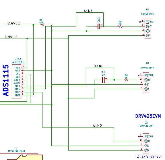

  • Hi Javier, thanks for your quick replay. Here the information that you required:
    So S1 and S2 are two different sensors that measure the same behavior?
    S1 and S2 are two DRV425 sensors that measure the surrounding magnetic field in the lab. I am not worried that they measure the same signal because I aligned them with that purpose, thus I can compare the effect of the low pass filter in similar signals (see figure 1). However I have several modules where they are disposed perpendicular each other (figure 2) and they still measure the same square wave pulses.
    To avoid this running the supply and the return current next too each other will cancel the field.
    The ground and positive lines are run next each other to avoid any kind cross talk (see figure 2). We also have modules in PCBs, and these are properly grounded to reduce this problem as well.
    Another question is what is your LSB size of your ADC that is measuring the voltage?
    LSB size = 31.25 muV @ gain = +-1.024 V, where muV is microvolts. This configuration is the same for sensors on the field and some of them don't show these pulses, I think the problem could be something else.
    Do the S1 and S2 share a reference?
    Yes, we are using the multiplex version of the ads1115 (see figure 2) where the reference is a3= 2.4V.
    Please let me know if you need more information.
    Thanks for your help,
    Figure 1
    Figure 2
  • Juan,
    I think you have an external field getting generating that is changing in the same square wave.  I would measure the current and see if you get any changes in the same manner.  The issue here is you need to measure and be able to see this signal vs the noise that you are using to measure.  Below are why I think it is an external source you are dealing with.  This could be magnetic field or voltage sources moving that are causing this error.  I would look at all your sources as well and make sure they are not doing something.   From my experience the movement is normally from an IC or instrument going into different compensation or adjustments for temperature or something else.  Looking at temperature could determine if something is trying to compensate for temperature.  If you have external instruments compensating temperature if they have cycles this could also be the issue.
    Please let me know if this helps and please share the root cause once you have found it.
    If perpendicular does the square wave have the same magnitude for both DRV425.  I think it is an external source for two reasons.  The DRV425 sync up.  That means that they both see the same external signal.  They are independent so anything internal would not be in sync.
    By Reference I mean the Reference connected the the Ref In pin.  This evidence also leans to and external field being generated.  Each DRV425 has a Reference Voltage generated internally  (Ref Out) and driving the Ref In.  The diagram shows you are not driving the Reference In pin but allowing the Ref Out to drive the Ref In for each device.  This means that each DRV425 has independent Ref In.  So that should not be the issue.
