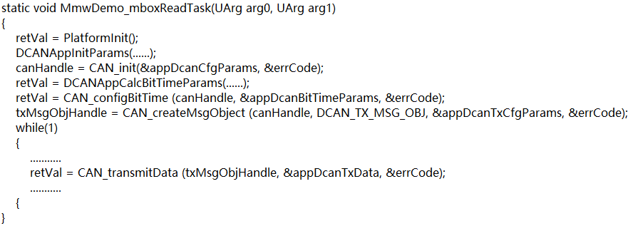

  • I use functions in CAN to change my program.  retVal = CAN_transmitData (txMsgObjHandle, &appDcanTxData, &errCode);

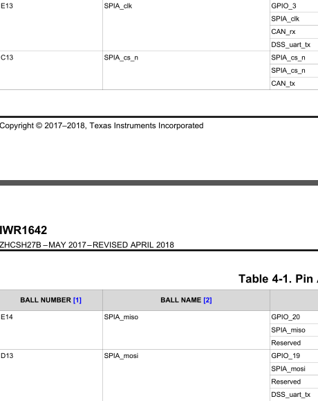

    I looked at he Pin Attributes of iwr1642.There is no CAN-FD pin,only CAN pin,E13 and C13.
    Is it necessary to change the program according to can-fd?

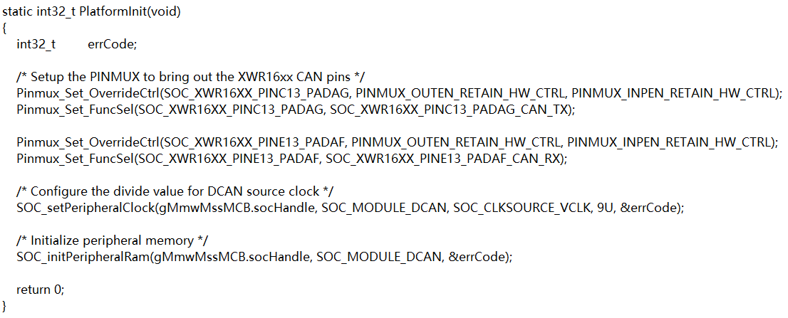

    There is different pin-muxing for CAN and CANFD. Please refer to test code PlatformInit() function in main.c :
    C:\ti\mmwave_sdk_03_05_00_04\packages\ti\drivers\canfd\test\xwr16xx
    and
    C:\ti\mmwave_sdk_03_05_00_04\packages\ti\drivers\can\test\common
    Yogesh
  • CAN still has no output, I would like to ask if my program is wrong?
    Please try and get the code @C:\ti\mmwave_sdk_03_05_00_04\packages\ti\drivers\can\test\xwr16xx working.
    If this is not working, the issue is in your setup. Once you have the test code working we can debug your code.

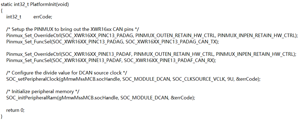

    Could you please share the platformInit() function.
    Also please verify the bit-timing used here matches with the external CAN emulator bit timing.
    Yogesh
