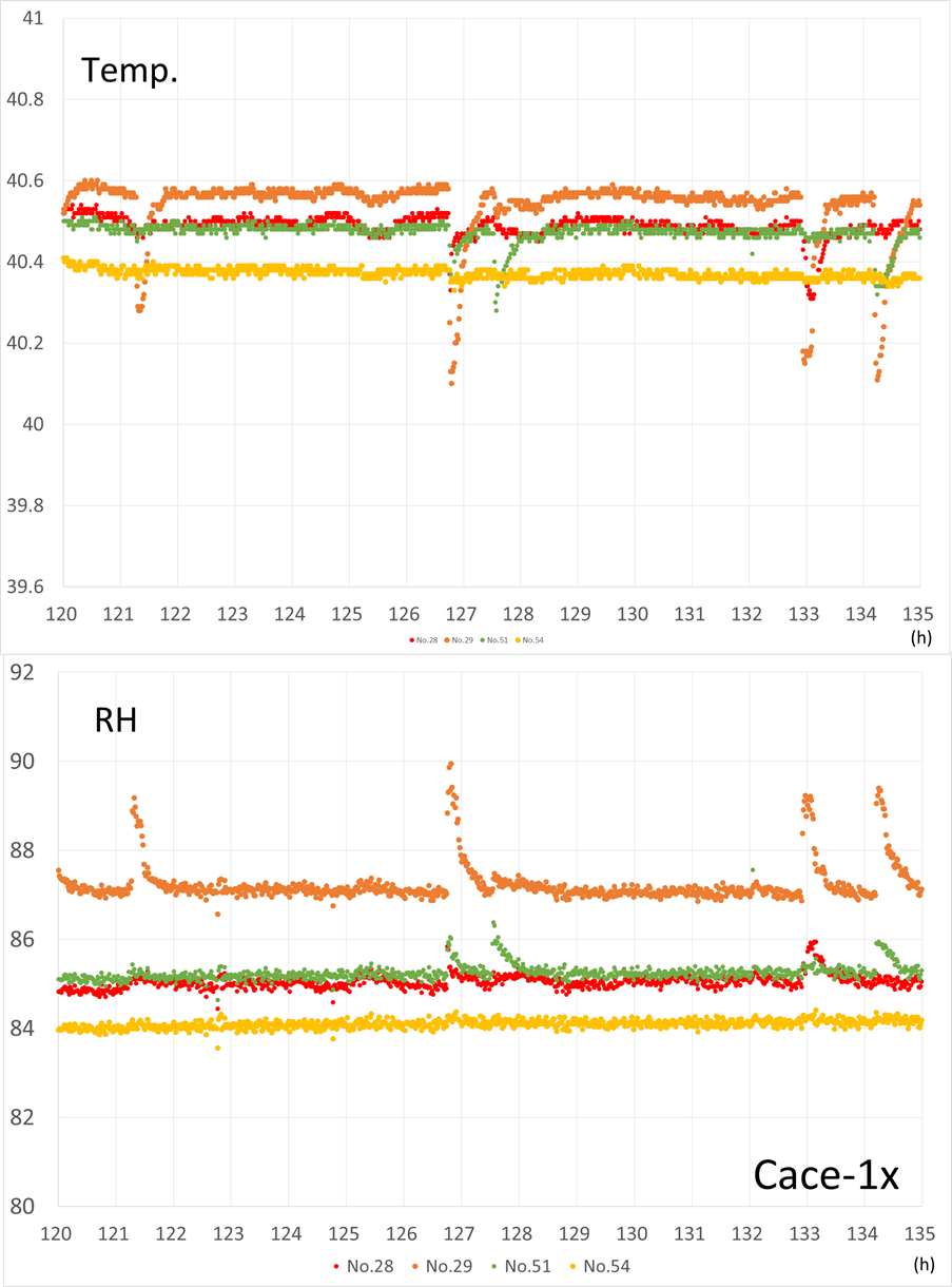

Please tell me for the phenomenon that happened during examination of the quantity of humidity drift.
I set up 2 samples to a chamber and measured data every one minute.
(Case-1)
The phenomenon that temperature and humidity slightly shift is sometimes caused to be in the lower figure.
This phenomenon occurs several times for one hour.As this phenomenon occurs with each sample separately, there is not the cause to a chamber.Do you think that what happens with a sensor?

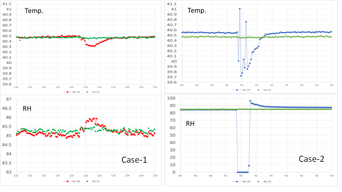

(Case-2)
For several minutes, humidity became 0%RH, and temperature became unstable.
I can measure other sample without a problem.What should I do to evade such a case?

  • Toshi - from your CASE 2 %RH capture, this looks like a firmware issue that I documented in the FAQ that I pointed you towards. In my experience with folks writing firmware for this part, the best way to see this is to put a logic analyzer on it and see for yourself what timing you have which makes the device return 0x00 0x00 for the humidity data, because not enough time is given for conversion to be completed.
    For CASE 1 temp and RH, the capture is zoomed in quite a bit, and the part looks to be within expected range for both temp and %RH - can't tell for sure, since I don't know how many samples that represents. There is some movement here, but again, it looks to be reasonably OK and your chamber may have moved around slightly and the HDC caught it doing that.
  • Dear Josh
    In Cace-1, I think that the change in the chamber surely becomes the trigger, too.
    But the temperature-humidity is moving a big change like Case-1x than I image.
    As the instructions level of the chamber is approximately constant, I do not think that temperature-humidity is doing a big change.
    I think that I cannot explain it only by being sensitive.
    Why do you think that it is behaved in such ways?
    In Case2, you seem to be regarded as a issue of Conversion, but then I ask a question newly.
    What is the reason why Conversion is delayed?
    I think that the frequency of the internal clock does not greatly change.
    Because a value is not stable, by averaging processing to perform until precision is guaranteed, will conversion be late?
    In this case will Conversion not be over in 1500usec?
    Please tell me if there is the method that can guess the conversion time of every time.

    after looking at your Case 1 graphs, i have come to the conclusion that the parts are picking up variations in your chamber. It makes sense as when temp goes down, %RH goes up. We see this all the time in our own chambers, as it is trying to maintain stable environment at high %RH conditions.
  • Dear Josh
    In Case-1, you think the relations of the humidity temperature are right.
    However, it is time before returning that I keep in mind.
    It takes around ten minutes to be restored.
    In the same chamber, four samples should have a similar tendency.
    However, four samples are not necessarily the same tendencies.
    How can you explain this?
    In addition, I do not understand origin of Case-2 at all.
    At the time of the real use, this is a problem more.
    Why would humidity show 0% of around ten minutes?
    Other samples give normal level then.
    This phenomenon occurred several times during two weeks.
    The solution to Case-2 is urgent.
    Toshi

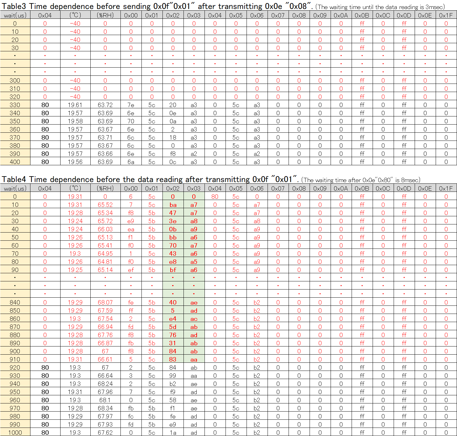

    ・I got the following facts about waiting time.
     If waiting time is short in the case of Soft_reset, the data are initial values.(Table3)
     Even if waiting time is short in case of Measurement trigger, humidity is not 0%RH.(Table4)
     And, even if DRDY does not become 1, humidity is not 0%RH.(Table4)
    For the moment, I will adopt your advice and challenge the evaluation in analyzers using GPIO.
    Toshi

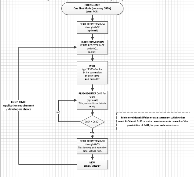

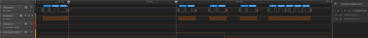

  • Toshi, with regards to the time to wait after software reset, i found that >550uSec was about the minimum to wait (at room temp) if issued before initiating further I2C communications, and this should be checked on your side over temperature if you leave it in, and again i recommend to remove it. Going below that leads to negative results as you have seen.
    If you can have a look at this simple flow, which is just firmware, not using the DRDY/INT pin, this is a very robust approach.
    and also here is logic shot of the loop above, but with the DRDY/INT also involved to trigger read of the 0x04 register, for best results from what part can offer you in the form of notification that fresh data is indeed available and the IRQ is serviced and reset.

    all your times are way too fast. Please follow my guidance, which matches the datasheet and the way the part is intended to be handled.

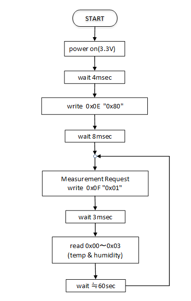

  • Dear Josh
    I say many times. I am measuring at 3 msec after the measurement request every time.
    <control procedure>
    Add 3.3V - - (900 msec) - -> write 0x0e "0x80" - - (8 msec) - -> 0x0f "0x01" - - (3 msec) - -> data read ... wait ...(repeat: 0x0f "0x01"----> data read ... wait ...)
    I only showed ability of HDC2010 to you.
    Though the waiting time is 3msec more than ability, why does Case-2 occur?
    I am asking you for this question.

  • Toshi, your chart in previous says uSec (microseconds), yet you continue to reference 3mSec (milliseconds) - sorry for the confusion, but i can only base advice on what you are providing, to me it seems this way.
    if you have any logic captures with timing as i have provided to you as examples, this would show us what is actually happening.

  • Toshi -
    sorry for the delay in getting back to you on this. I did receive the collateral from our local guy helping you.
    Please find attached working Energia code and logic capture which you can use directly or for reference.
    /cfs-file/__key/communityserver-discussions-components-files/1023/6607.HDC2_5F00_address_5F00_40_5F00_one_5F00_shot_5F00_01_5F00_21.txt
    /cfs-file/__key/communityserver-discussions-components-files/1023/HDC2_5F00_one_5F00_shot_5F00_example.logicdata
    Viewer for the Saleae file is here : https://www.saleae.com/downloads2/
    I used both MSP430F5529 and MSP430G2553 – only difference was the UART baud rate
    This code uses I2C address 40 as you are and issues first start conversion in setup, with correct waiting time.
    After going into loop, second start conversion is at the end, with the waiting time set correctly, but with other lines you can comment in/out as you like to see the behavior
    In here on line 75, I also placed an if statement, which, when waiting time is too short, will not read values out of the device until register 0x04 reads 0x80 (or 128 dec)
    There are no issues using 3mSec or more, but 1.5mSec is recommended when using 14 bit conversion setting.
    The current loop delay is set on line 99 and is currently set for 1 sec.
