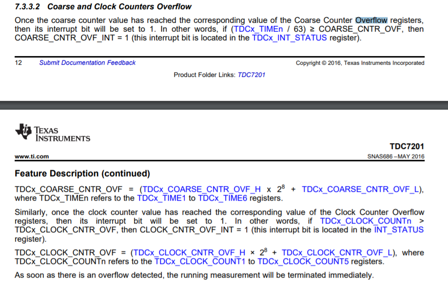

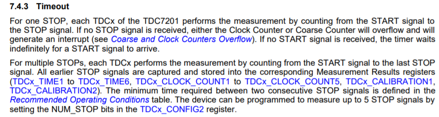

    Up to 5 stop signals can be measured. If the device does not receive the specified number of stop signals then it waits until the clock counter overflows and an overflow interrupt is set. If this happens, this will immediately end the measurement and INTB will assert low, but the counter results for the stop signals that were received will still be available in the TDCx_TIMEx and TDCx_CLOCK_COUNTx results registers. FORCE_CAL=1 would need to be set to perform calibration regardless of overflow.
    See post 867524
    TDC7201 datasheet 7.4.3:

    As you say
    Can I set the timeout Time?
    Ex:Set the timeout in 20us.
    Craig
  • Hi Craig,
    Yes, the clock overflow count is a 16-bit value that can be set in the TDC720xEVM GUI: CLOCK_CNTR_OV_H (upper 8 bits), and CLOCK_CNTR_OV_L (lower 8 bits).
    For example with a 16MHz clock, setting CLOCK_CNTR_OV_H = 0x1, CLOCK_CNTR_OV_L = 0x40 would equate to 20us (320 clock periods).
