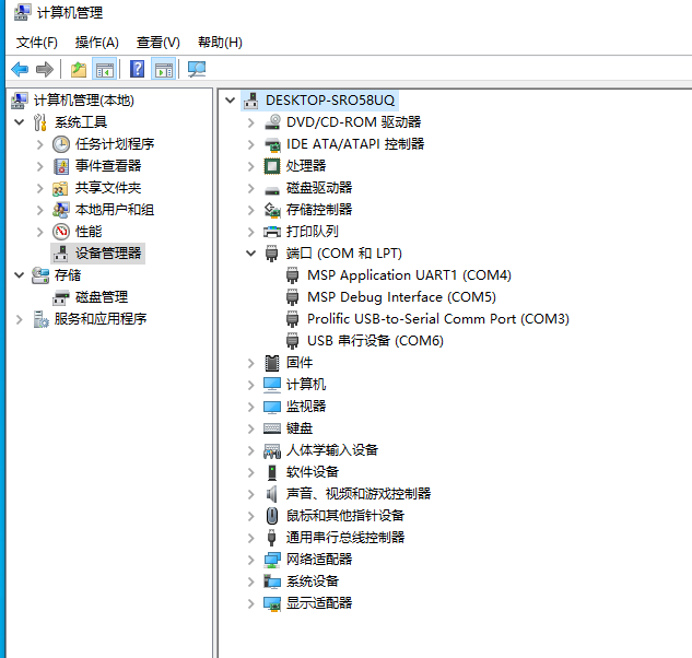

    I have used the UniFlash tool to make my Msp430 Firmware upgraded successfully. And I have installing CCS and MSP430ware. But I also do not see the results in section 4.3. Including the step found in posts 928437 and 881110, I have tried to install labbiw and other software mentioned in these two posts, but I still haven't solved the problem. The picture is mine Ports(COM & LPT) list. I hope I can get your further help. thank you!

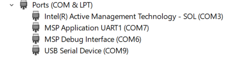

    Plug in the hardware first, then open the GUI and try connecting through the COM ports listed.
    It should connect with "USB Serial Device" (COM9 for me)
    It will say "Connect Successful!" at the very bottom of the GUI if it works.

    Yes,I can get a hint that the connection is successful. Do you mean that this step is enough and the verification result of step 4.3 does not need to be handled?
    Because After I plugged the TDC7201EVM module into the MSP430 board after connecting to the computer, I still could not find the TDC7201 port mentioned in
    Section 4.3. Then,I have tried to enter start and stop signals, but the GUI's display didn't respond.
    zhangli
    If the GUI says is connected successfully, as long as you see the same COM port in device manager that the GUI sees, that should be fine. The User's Guide uses a different version of Windows and an older GUI revision, which may account for the difference. You can further test the connection by reading and writing device registers on the "debug" tab of the GUI. If the connection is verified and you are having another issue with the GUI or EVM, please open a new thread with the details.
