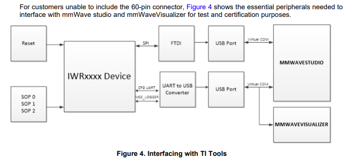

    Document SPRACP3A figure 4 specifies that only SPI CFG Uart and MSS_Logger is required. See diagram below.

    2) Is the Radar-mss_logger pin required to be connected - I can not see any option for where this connects to this com port in mmwave studio?
    Are you using the same FTDI on the MMWAVEICBOOST?
    The Radar-mss_logger is not needed to interface with mmWaveStudio.

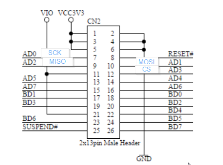

    I have copied the EEPROM from the MMwaveICboost FT4232H to the DS_FT4232H_Mini_Module and wired to the same pins as the dev kit is using. MMwave Studio detects and communicates with the DS_FT4232H development board Ie SPI coms is outgoing and data is coming back but still errors. See below for wiring.
    Are there any other SPI pins required to be connected?
    Cheers,
    Matt

    2a- I have now connected host_INT which allow the SPI coms to get further. But still seems to be getting stuck - see above. There is definitely SPI communication occurring with what looks like valid data going on MOSI and MISO.  I can provide this if it would help diagnose the problem?
    2b -Reset. I have put a logic analyser on the reset pin and this is only asserted on "Set (1)" command, I have asserted this internally in the MCU on startup which should be that same.
    Matt
