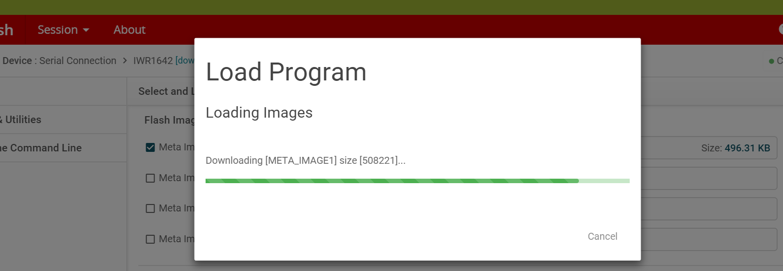

 Can I flash a image whose size is greater than 512KB in Meta Image1 - Uniflash ?
By the way, can you tell me the maximum size of the four parts of the recordable file?
    Yes, you can flash meta-image with size greater than 512KB.
    Not sure if I got the second part.
    Yogesh
  • In fact, when I was burning a 496K file, it stopped burning near the end. Why is that?
    One more problem, I parsed my bin file.
    There are about 12 FF's in it. Is it because Uniflash can't burn these 12 FF's that the progress bar gets stuck?
    Could you please share the log. It doesn't seem to be size issue.
    Yogesh
  • I am not sure whether the log you need is this one. If not, please tell me the method to get it. Thank you.
    [2021/1/26 下午2:28:10] [INFO] Cortex_R4_0: Initialization complete.
    [2021/1/26 下午2:28:10] [INFO] Cortex_R4_0: Flashing process starting...
    [2021/1/26 下午2:28:10] [INFO] Cortex_R4_0: Connecting to COM Port COM7...
    [2021/1/26 下午2:28:10] [INFO] Cortex_R4_0: Reset connection to device
    [2021/1/26 下午2:28:10] [INFO] Cortex_R4_0: Set break signal
    [2021/1/26 下午2:28:10] [INFO] Cortex_R4_0: Connection to COM port succeeded. Flashing can proceed.
    [2021/1/26 下午2:28:10] [INFO] Cortex_R4_0: Reading device version info...
    [2021/1/26 下午2:28:10] [INFO] Cortex_R4_0: ** 1 files specified for flashing.
    [2021/1/26 下午2:28:10] [INFO] Cortex_R4_0: Checking file C:/Users/Administrator/Desktop/sblm.bin for correct header for IWR1642.
    [2021/1/26 下午2:28:11] [INFO] Cortex_R4_0: IWR1642 device, fileType=META_IMAGE1 detected -> OK
    [2021/1/26 下午2:28:11] [INFO] Cortex_R4_0: !! Files are valid for IWR1642.
    [2021/1/26 下午2:28:11] [INFO] Cortex_R4_0: Format on download was specified. Formatting SFLASH storage...
    [2021/1/26 下午2:28:11] [INFO] Cortex_R4_0: -->Erasing storage [SFLASH]
    [2021/1/26 下午2:28:11] [INFO] Cortex_R4_0: -->Sending Erase command to device...
    [2021/1/26 下午2:28:12] [SUCCESS] Cortex_R4_0: -->Erase storage completed successfully!
    [2021/1/26 下午2:28:12] [INFO] Cortex_R4_0: Downloading [META_IMAGE1] size [508221]
  • Are you able to flash the pre-built binary C:\ti\mmwave_sdk_03_05_00_04\packages\ti\demo\xwr68xx\mmw\xwr68xx_mmw_demo.bin to rule out any issue with your binary?
