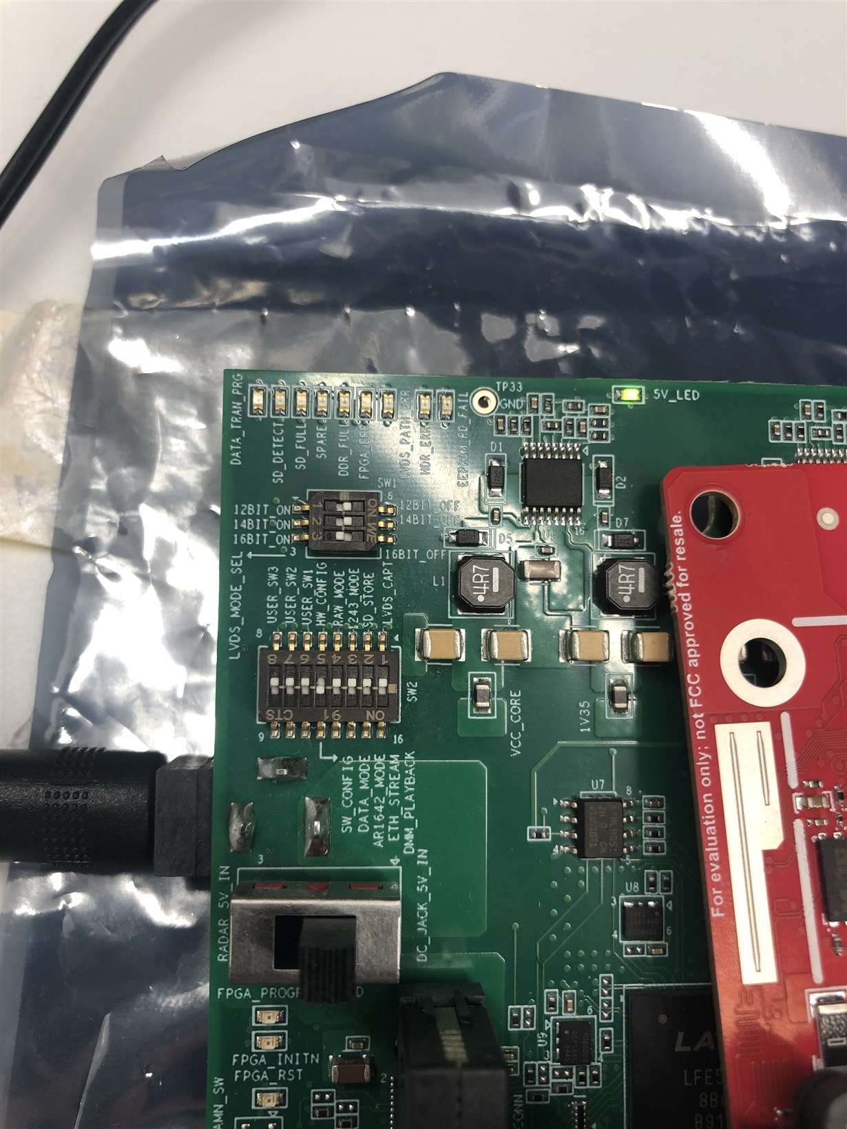

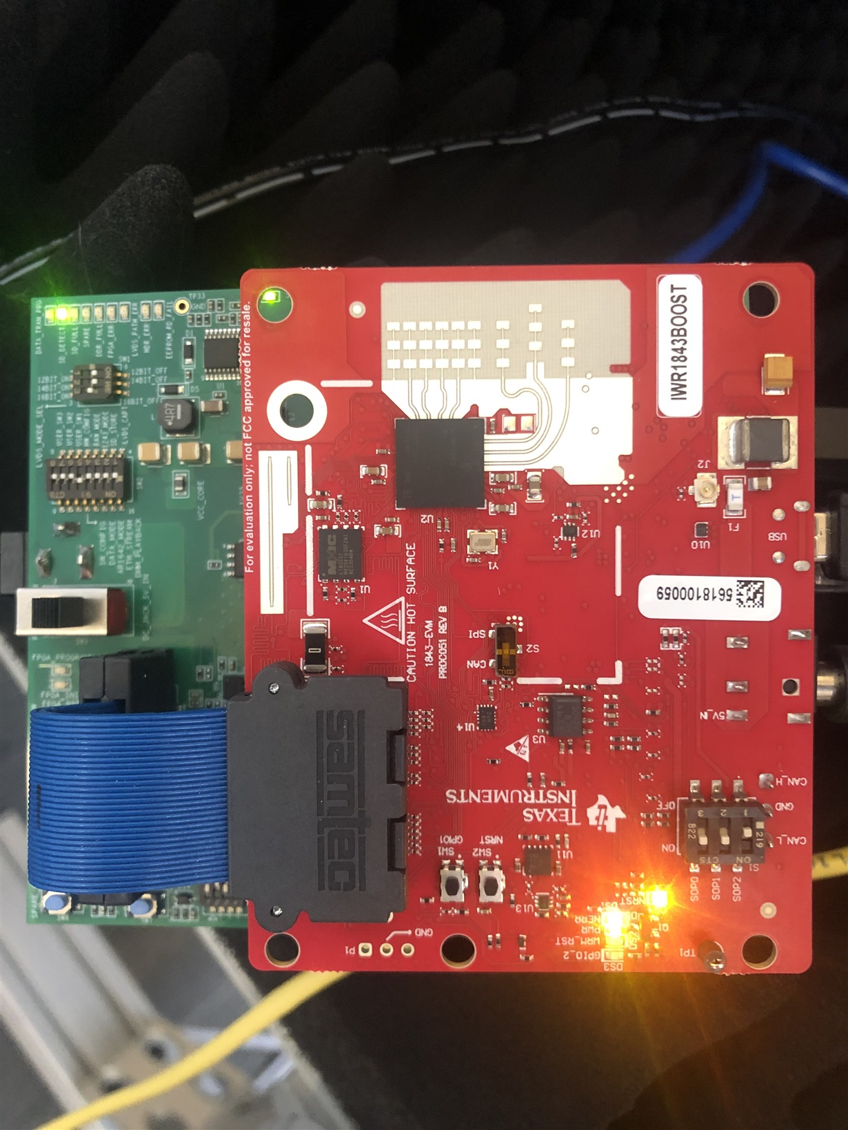

I have the IWR1843BOOST + DCA1000 and want to use mmwave studio to stream data, SOP is configured as 011

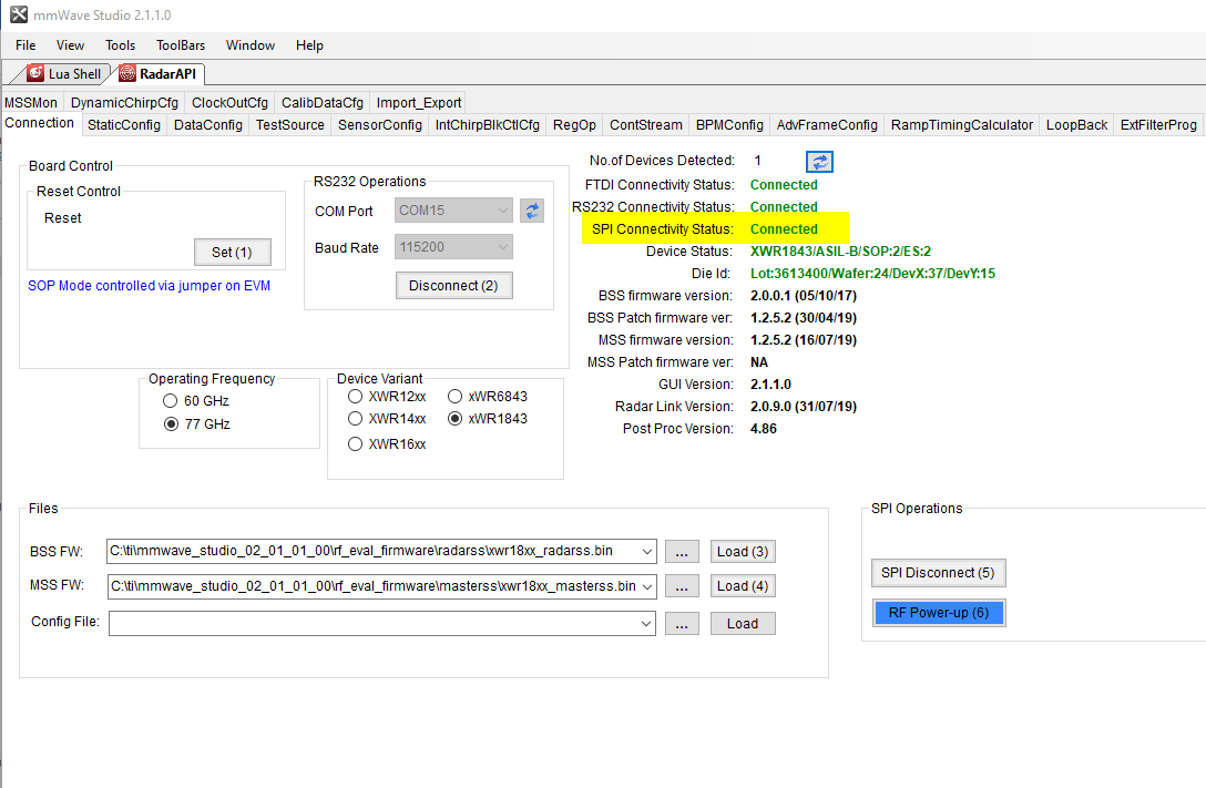

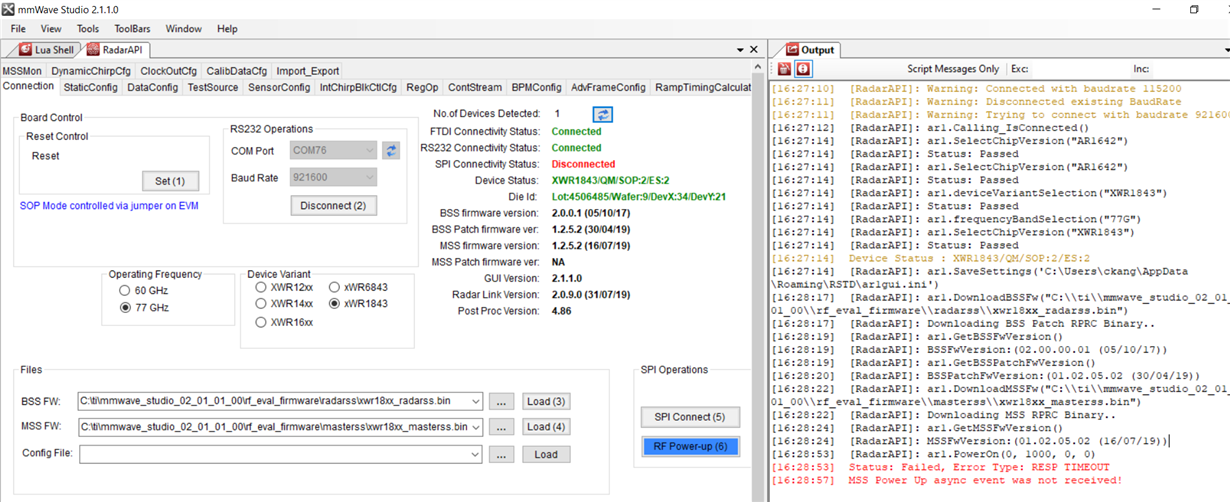

But when i click SPI connect, i got RESP TIMEOUT error.
i am using mmwave studio 2.1.1.0
and I just ordered the IWR1843BOOST, so it should be ES2.0
