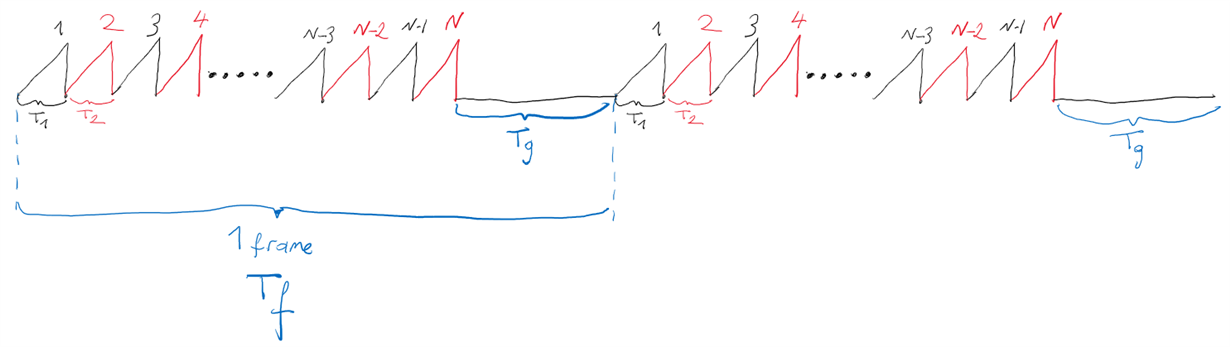

I need a quick clarification of "No of Chirp Loops" and "Periodicity (ms)" configuration parameters in mmWave Studio application. I am also providing a figure (as attached) to help with my question.
I have two different types of chirps as shown (red and black) Let's assume the duration of these chirps (i.e. T1 and T2) are the same. Each radar frame consists N such chirps as shown (N/2 black and N/2 red chirps in each radar frame). Each radar frame period ir Tf as shown. Tg is the time gap between consecutive frames.
My first set of questions are as follows:
1 - Is "No of Chirp Loops" = N ?
2 - Is Tf = "Periodicity (ms)"?
3 - Does the tool calculate the time gap between frames (Tg) automatically?
My second set of questions are related to the "Active-Ramp Duty Cycle" and the "Duty Cycle" parameters that are automatically calculated in mmWave Studio. I'm including the famous chirp reference diagram below to assist.
My questions are:
1 - Is "Duty Cycle" = (Tf - Tg) / Tf ? (based on the first diagram above)
2 - Is "Active-Ramp Duty Cycle" = T(tot) / Tf where T(tot) is the total time of all the "ADC Sample Time" (as indicated in orange below) for each chirp inside a frame?

  • HI, Cagri:
    Please see my answers inline.
    From the figure, in this frame, you have two type of chirps, (red and black), so you should define two chirp, chirp index 0 and chirp index1, and the number of chirp loop should be N/2 in your case.
    Yes, Tf is the frame period.
    Yes, Tg will be calculated automatically.
    Regarding your second set of questions
    Yes.
    For each chirp, the total duration is the chirp idle time plus the chirp ramp time.  The active ramp duty cycle only accounts for the ramp time, not the idle time.  But the ramp time includes the adc start time, ADC sample time and excess time. So ADC sample time is only part of the total ramp time.
