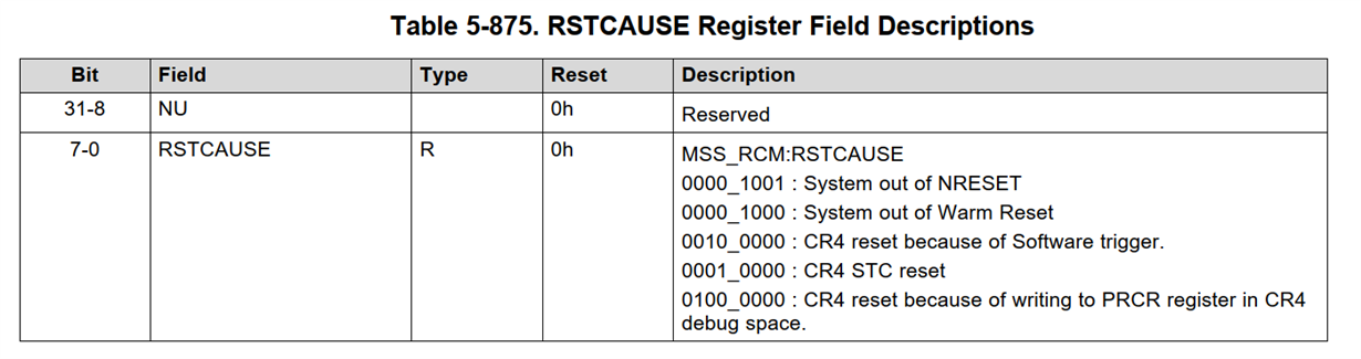

1.   After flashing my image and pressing nrst button , SPARE9 is :
0x00990099  ,  current == previous == NRESET.   All good.
2.  After executing  call SOC_softReset,  which does CR4 only reset,   I get SPARE9:
0x00990099  ,  current == previous == NRESET.     Same as after button reset.
Should I not be getting  "0010_0000 : CR4 reset because of Software trigger. "    Into the current mssRCM->RSTCAUSE ?
3.  With watchdog enabled,  after executing  SOC_triggerWarmReset, which should issue warm reset , I get :
0x028a028a   , and  have few questions here :
   - With system originally out of NREST (by button),  I expected 0x00990028a , i.e. the memory effect.  Why is it not here?
    -  The 0xa = MSS topRCM  reset due to MSS WDOG ok, but
        0x028 = 0010_1000   == ??  for mssRCM  what is this value?  I don't see this bit pattern on the link referred to above on SPARE9, or  from the Tech Ref manual for x1642.

5.  Manual & SPARE9 values contain these :
0000_1000 : Warm Reset
0000_0010 : MSS only Wdog Reset.
0000_0100 : MSS subsystem reset because of Software trigger.
1000_0000 : CR4 only Wdog reset
I don't seem to get any "warm" resets;    Is there difference between CR4 only Wdog reset and MSS only Wdog (  is there any other usable wdog on MSS side, besides one in RTI?  Does CR4 has it's own internal wdog? );
And when should I expect to see otthers - what to trigger to get them.

  •  .. Just in case that part 3) was not scanned by you in all details, this is what I wrote:
    Again, No memory effect I see,  and some un-expected pattern .
    It is OR of different reset cause.

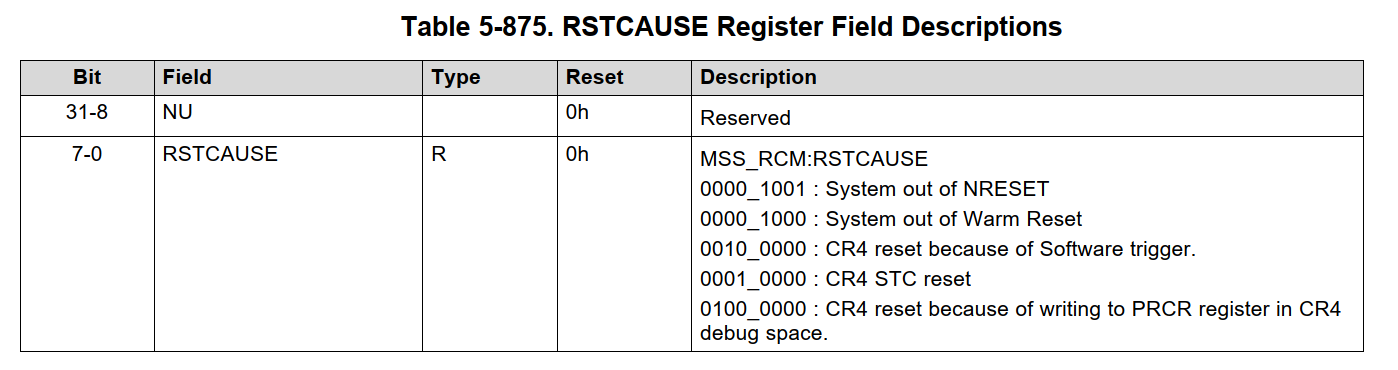

    0x28A :
    SPARE9 [11:4] = current MSS reset cause (mssRCM-> RSTCAUSE)
    SPARE9 [3:0] = current system reset cause (topRCM->SYSRSTCAUSE)
    0x28-->  OR of below two values
    0xA --> “1010” : Warm reset because of MSS Wdog.
    Looks like WDT reset happens multiple times so both of 16bit values are same (WDT RESET cause).

  • Hi Jitendra,
    Per the above definition of the bitfields,
    bit 0 to 3  (4 bits) is topRCM->SYSRSTCAUSE,   thus it should contain  0xA only.
    bits 4 to 11  (8 bits)  is mssRCM->RSTCAUSE ,  and thus should contain 0x28 per the given above map;
    Hex 0x28   / dec 40 is  bit pattern  0010_1000 , which I quite agree with your map above, but where in the TRM is mentions that it can be OR'ed with the Warm reset  bit pattern ... ?
    I didn't find mentioning of possible OR'ing of those bit maps, or just possible OR'ing of one specific  that Warm reset can be ored with others.
    Perhaps there is another doc?
    Thank you for the explanation however.
