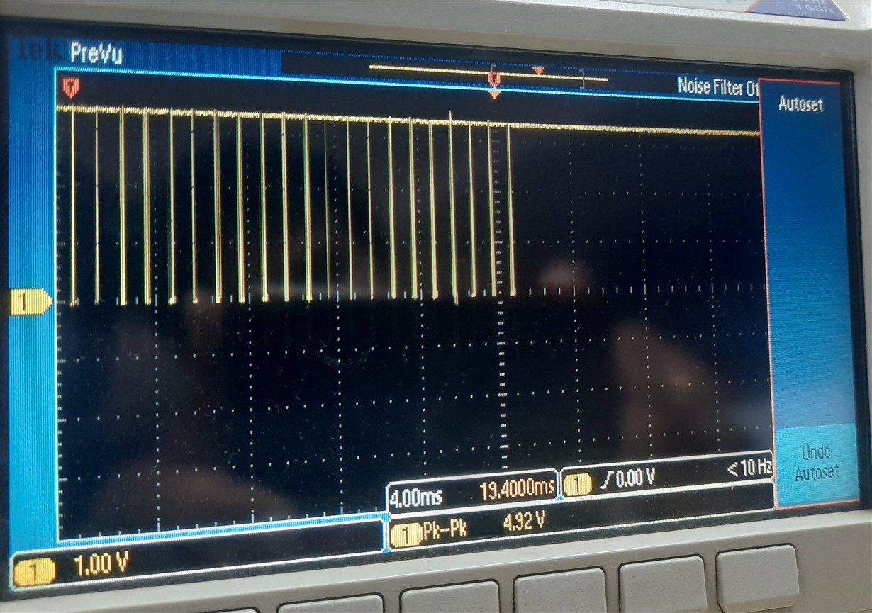

    Have you configured the SPI/CAN switch on the boost EVM?
    Can you please check with a scope that you see data on the CAN lines?
    Thank you
    Cesar

    We are using AWR1642Boost EVM of "Rev A".
    In "Rev A" SPI/CAN switch is not present.
    and probed the CAN lines and can able to see the data for a few seconds and stops updating(below Image) immediately.
    Vijaya Krishna.
  • Vijay,
    If you are using Revision A of the AWR1642 board, this will involve make physical changes to the board to enable the CAN lines being brought out to the CAN connector. Did you make any changes to your AWR1642BOOST EVM?
    Kyle
