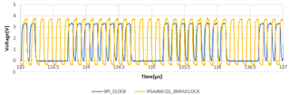

  • Hi Mekre,
    I measured the voltages of SPI clock and 8-MHz clock test pin(TEST_MUX VALUE = 0x05).
    As I see, SPI speed(BLUE line) was 8 MHz.
    However, the logic high/low timing of SPI clock and 8-MHz clock of PGA460 didn't match.
    Can this be the problem?
  • Hi tr,
    If the timing of the SPI clock edges was consistent and the frequency matches the device frequency, this may not be an issue after the first sample.  When I look at your graph, I noticed that there is a gap between some of the SPI clocks though.  Since the direct data burst data is not buffered (https://e2e.ti.com/support/sensors/f/sensors-forum/897329/pga460-q1-is-there-any-buffering-of-the-direct-data-burst ), it is possible that you may lose samples.  To verify if this is an issue, you can set SAMPLE_SEL to 1.  By setting SAMPLE_SEL to 1, the MS Byte is padded with a 4 bit sample counter.  After doing this, check the sample counter to see if it is being properly increment between samples.

  • Hi tr,
    The gap in the clock seems to happen after 8 clock cycles from your graph.  This may be from the delay in reloading the SPI TX buffer between the dummy writes used to active the clock.  If you were to decrease the delay between the dummy writes by using the DMA of your microcontroller, that should help reduce the number of skipped samples.  You may still  skip samples though if your clock is slow.  To deal with the skipped samples, you could try to use the previous sample value for a given data point that was skipped in post-processing of the collected data, as is mentioned in the below post:
    e2e.ti.com/.../pga460-q1-is-there-any-buffering-of-the-direct-data-burst
    Mekre
