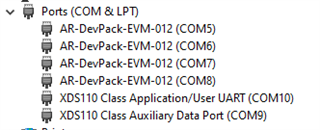

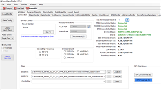

I get some SPI connection problems on mmWave studio and the devices that I'm using are AWR1843Boost Rev. B and DCA1000EVM.
The device status and error messages are shown below:

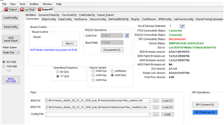

Can you check if switch S2 on the EVM is set to "SPI" and not "CAN". (Please refer to AWR1843 EVM user guide to locate the position of the switch. By default, the switch is set to ON position or "CAN").
Ishita
Glad to hear that.
