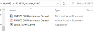

  • Hey Scott,
    Thanks for your reply.
    Here are the contents of the zip file that Tom linked me. There is no firmware as far as I can tell can you let me know if there is a different link that contains the firmware?

    The three items there are:
    • The full datasheet.
    • The .exe program to install the PGA970EVM GUI

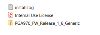

    • The .exe program which seems to install the FW in C:\Program Files (x86)\Texas Instruments\PGA970GenericFirmware in a .zip file.
    May I suggest perhaps replacing that PGA970-Generic-Firmware-Installer.exe with just a zip of the folder contents shown below?
    After getting suspicious since a zip file with the FW was what I was expecting and I figured you were sending me the FW in some manner, I took a look at what the .exe did for the FW installer and realized the FW was in there and being copied to that directory which is a bit confusing but I could be mistaken. I just wanted to let you know that was the case.

  • Hi Eric,
    The example firmware is packaged as an installer for the purposes of going through the clickwrap license before installing it.
    1. I'm not sure what firmware is included in the hex file to be honest. The PGA970 does not come with any firmware installed from the factory. The hex file is likely based on the example firmware, but since the example is mainly only shell functions, there is not much functionality already included.
    2. You can load the hex file, but as I mentioned above, there will most likely be no useful functionality as a part of it. Updating the firmware for the required application is up to the user.
    3. For flashing firmware in a production environment, using the XDS200 with CCS or Uniflash is the preferred method. If you are only evaluating for the moment, you can load a hex file using the USB2ANY through SPI/I2C/OWI. If you need debugging capability, you will have to use the XDS200 with CCS.
