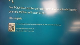

I have combined both the awr1243boost design and mmwave devpack board designs onto a single PCB. I attempted to keep all portions of the board the same, save for a few redundant traces in regards to communicating between the two boards. I have successfully programmed the XDS110 debug probe (TM4C chip), and the FTDI chip (I think), but when I plug into the FTDI USB port my computer will bluescreen with error "KERNEL SECURITY CHECK FAILURE". When I launch my computer into safe mode and connect the board I do not get blue screen. Additionally, while this happens the 4 LEDs on mmwave-devpack with labels DS11 to DS14 blink on and off.
Unfortunately, when I am in safe mode, I am not able to use radarstudio. For some reason, the "RS232 Operations" section shows no options for COM ports and I suspect this is to do with being in safe mode. When I try to run mmwave link example from mmwave-dfp, the application fails at Radar/RF subsystem powerup. Any insight into what could be causing this failure would be appreciated.
