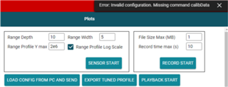

    I also try to load below cfg File by clicking "LOAD CONFIG" on Visualizer tool to check "Chirp/Frame" of this cfg.
    C:\ti\mmwave_industrial_toolbox_4_5_1\labs\robotics\ros_driver\ti_mmwave_rospkg\6843AOP_3d.cfg
    But it seems to be Error like below;
    Question:
      Could you tell us how to load this "6843AOP_3d.cfg" on Visualizer tool?

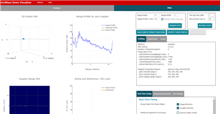

    YES!
    I can success to run OOB-demo selected SDK version 3.5 from the drop down menu like below;

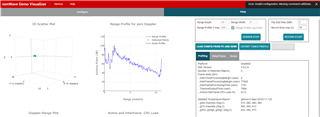

    But we found error by loading below cfg File by clicking "LOAD CONFIG".
    We would appreciate if you check the behavior with 6843AOP_3d.cfg and IWR6843AOPEVM by clicking "LOAD CONFIG" on Visualizer tool.
     P.S. I'd like to share "clear screen-shot" as below pdf.
    vis.pdf
  • Thank you for sharing the images and the pdf.
    The error describes a missing command "calibData". You can add this command "calibData 0 0 0" just before "sensorStart" by editing the 6843AOP_3d.cfg file.
    I've tested the cfg file myself and did not see issues. Could you please post your cfg in its entirety so I may compare?

    It seems to success to run the deme on visualizer with 6843AOP_3d.cfg from your advice.
    Thank you!
