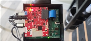

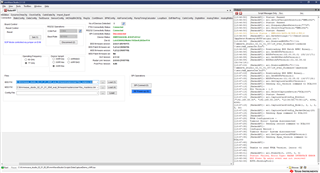

Hello. I am trying to get the board using mmwave studio 2.1.1.0 and I keep hitting a stop at step 5 when you are supposed to connect the SPI. I receive the following error.
[13:48:06] MSS Power Up async event was not received!
[13:52:33] RSTD.ShowLogFile()
Full log:
I previously had this running and it stopped working suddenly if that is any help.
Thanks.
