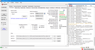

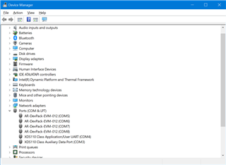

I am trying to connect AWR1843BOOST and DCA1000EVM with mmWave Studio. I am struggling to download binary files to BSS and MSS. I made it to reset board and get RS232 connected. BSS FW is downleaded, but indicated version for that is 0.0.0.0 which shows it is not done correctly. When I tried to load binary file to MSS, it causes the program to get stuck displaying "0% Downloading Firmware to device ..." and nothing happens. Please see the picture of RadarAPI GUI after that. As I checked in device manager, all necessary 6 COM files are detected successfully (see fig 2) and I can ping IP address 192.168.33.30 without any problem. SOP switches are adjusted as mentioned in mmWave_studio_user_guide (SOP0 and SOP1 are OFF, SOP2 in ON).
I see very similar post in TI forum which apparently is solved just by using  two separate supply power for DCA and AWR, however, I am already using two supply power for them (SW3 in DCA1000 in on DC_JACK_5V_IN) so it is not my case.
e2e.ti.com/.../dca1000evm-awr1443boost-mmwave-studio
In another post, it was suggested to clear leash using Uniflash, I tried it but it doesn't help.
e2e.ti.com/.../3529801
Any help would be appreciated!
