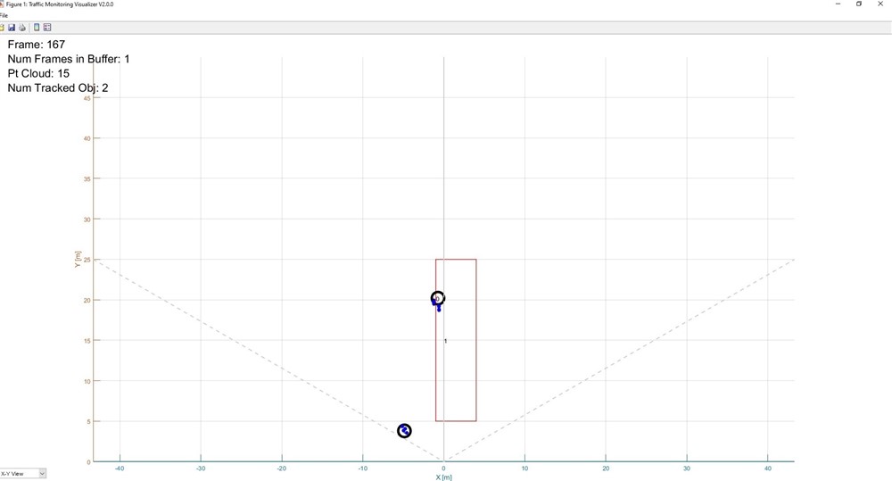

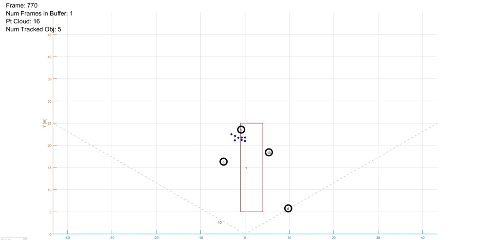

    2. In Long range the .cfg files that are available on the demo are generating the ghost points with both 2D and 3D .cfg files.
    If you see the below screenshots
    This is a screenshot from the 2D .cfg file. Only 1 is the actual target and it is creating multiple ghost points as the target is coming closer to the sensor.
    This is a screenshot from the 3D .cfg file. Only 0 is the actual target and it is creating multiple ghost points as the target is coming closer to the sensor but it is still better than the 2D.
    Now how do I get rid of these ghost points?

  • Hello Divya,
    I forgot you are using the AOP EVM. To use the AOP device with longer range area scanner, you must configure a region of less than 60 range bins.
    heatmapGenCfg -1 1  0 90 150 60.0 3.0 10
    The bold values give the reported range bins for static object detection. From the cfg file (area scanner default) each range bin is ~8cm. So this can be configured for any ~5m range. The above configures the sensor for about 7m (90*8cm) to 12m(150*8cm). These values can change depending on your range needs. To configure for 20m range, you could use 190 and 250 as the range bins, but you might be at the edge of what the AOP antenna can detect. Please make sure the chirp configuration can also support >20m maximum range (may require a chirp slope/BW change)
    And for the long range demo, have you tried adjusting the allocation and state parameters? This is the best way to modify the tracker allocation. Please see the customization guide below. (Note: the long range demo uses a slightly older implementation, but the adjustments should be the same)
    3D_people_counting_tracker_layer_tuning_guide.pdf
    Jackson
  • Hi Jason,
    Adjusting the allocation parameters and state parameters definitely helped us to get rid of the ghost points. Thank you for the help there.

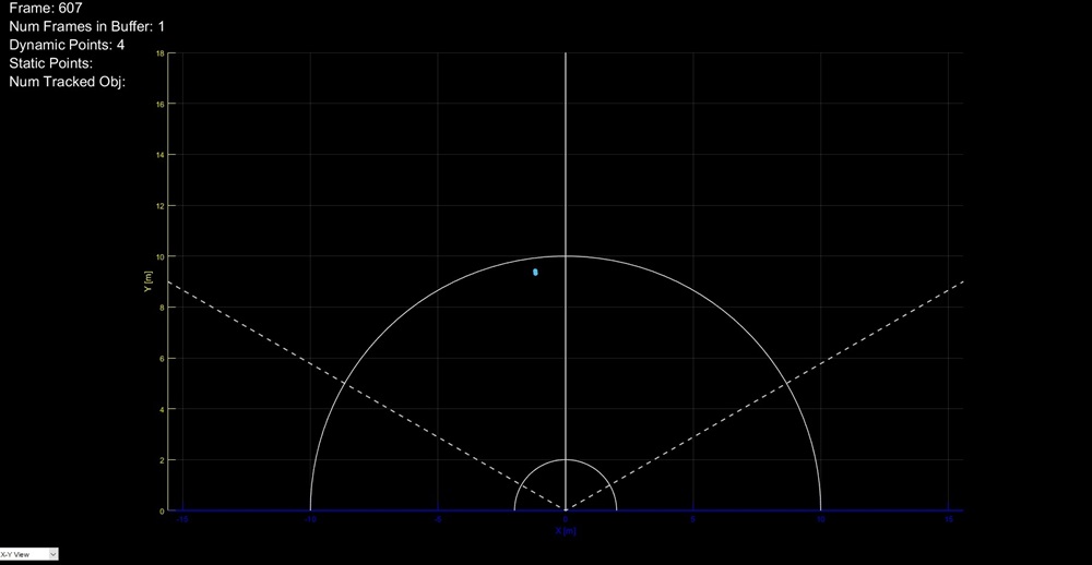

    In the area scanner I changed the parameters in the below function as suggested:
    heatmapGenCfg -1 1  0 90 150 60.0 3.0 10 but there is no change in the detection range after 8 meters it just turns into dynamic points as shown in the below picture.
    and
    heatmapGenCfg -1 1  0 190 150 60.0 3.0 10 but it is the same message that's been flashed.
    Warning: A timeout occurred before the Terminator was reached.
    'serial' unable to read all requested data. For more information on possible reasons, see <a href="matlab: helpview(fullfile(docroot, 'instrument','insrument.map'), 'serial_somedata')" '> Serial Read Warnings </a>
    How to solve this in the area scanner?
    Divya Teja Settimali
  • Hi Divya,
    For the first config line, 8m seems accurate. The range bin range [90 150] will cover about 7-11m from the sensor for static detection. But remember this is from the sensor and since the sensor is likely up in the air, 11m on the ground will be greater than 11m from the sensor.
    For the second line, you have the numbers reversed. The first number is min range bin and the second is max, so you should swap them as below.
    heatmapGenCfg -1 1  0 150 190 60.0 3.0 10, or did you mean to use 190 and 250?
