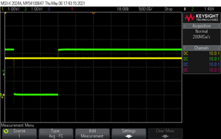

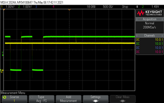

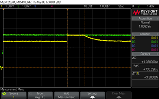

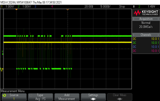

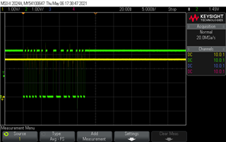

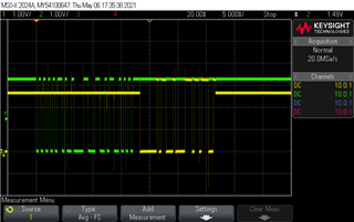

    I have attached some scope pictures below comparing the unresponsive PGA460PSM-EVM to a responsive device.
    As the writing of the TEST_MUX register is a no-response command (PGA460-Q1 datasheet page 38) I've also included an attempted reading of the DEV-STAT0 register, which is successful with one device but not the other.

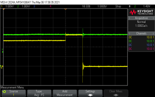

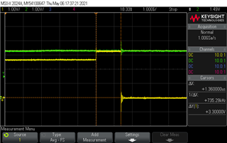

    You can see on the unresponsive PGA460PSM-EVM what appears to be a pull of the TXD line high at the expected time and for the expected duration (judging by the reply on the responsive PGA460PSM-EVM), however it then does not pull the line low as would be expected or show any further signs of activity on the TXD line.
    This initial pull-up does not occur if the wrong UART address is used.
    I am using a 10K pull-up resistor to 3V3 on the TXD line as I'm using multiple PGA460PSM-EVMs on the same UART bus as per this thread here: https://e2e.ti.com/support/sensors/f/sensors-forum/829633/pga460-q1-how-to-drive-multiple-devices-by-uart. This has worked successfully with the other three sensors. I do not use a pull-up resistor when interfacing with the MSP-EXP430F5529LP, as I only every use the MSP-EXP430F5529LP with one sensor at a time.
    In the scope plots the sensor under test is the only device connected to the UART bus.

    Green = RXD (from PGA460's perspective)
    Yellow = TXD (from PGA460's perspective)
    UART: baud = 2400, parity = None, stop bits = 2
    Both devices have UART address = 0
    Write TEST_MUX = 00; responsive PGA460PSM-EVM:
    Write TEST_MUX = 00; unresponsive PGA460PSM-EVM:
    Read DEV_STAT0; responsive PGA460PSM-EVM:
    Read DEV_STAT0; unresponsive PGA460PSM-EVM:
    Highlight on the initial TXD pull-up in the response; responsive PGA460PSM-EVM:
    As above, + measurements:
    Highlight on what appears to be an attempt at the same initial TXD pull-up of a response; unresponsive PGA460PSM-EVM:
    Wider angle on this initial TXD pull-up after a DEV_STAT0 read, correct UART address = 0 used; unresponsive PGA460PSM-EVM:
    Comparison showing this initial TXD pull-up after a DEV_STAT0 is not present when an incorrect UART address = 1 used; unresponsive PGA460PSM-EVM:
  • Hey Mark,
    Thanks for the scope captures!
    It looks like there is a way to return the device to factory settings using UART. It  not sure if it would work since you are having some communication issues, but I think it is worth a shot. This info can be found in the PGA460 data sheet under section 7.62
    This thread also contains some more info: https://e2e.ti.com/support/sensors-group/sensors/f/sensors-forum/814314/pga460-programming-problem-of-eeprom
    Let me know if this works for you Mark.
    Isaac
