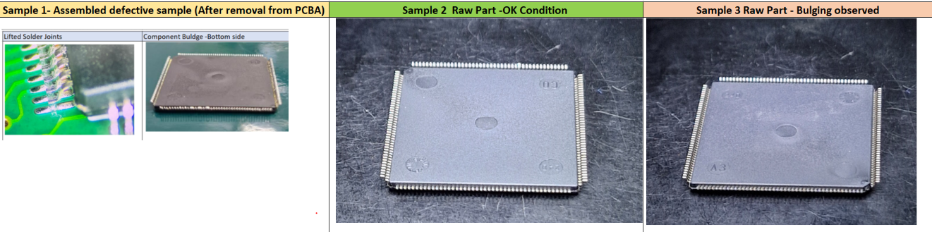

Plexus observed component surface bulging for Plexus PN: 100538110-DH-SDRM-643 , MPN: TMS320F28335PGFA as shown in below photo. Currently, we in progress evaluating the internal condition of the bulged component whether this bulging impacts the electrical/mechanical functionality of the component, or if it is purely a cosmetic issue. In the meantime, please advise the acceptabililty and reability of this parts conditions, as we found this conditions on a fresh/ unused parts (bulged at the same area). Lastly, are they still under warranty?

    Bulging Condition — Acceptability
    TI's published documentation does not define specific acceptance criteria for mold compound surface bulging, so I cannot confirm from documentation alone whether the condition observed is within manufacturing tolerances or constitutes a defect. That determination requires a formal quality review by TI's product quality team on a case-by-case basis.

    Potential Root Cause — Moisture Sensitivity
    This is worth flagging before escalating to the TI Quality and Reliability team. The TMS320F28335PGFA is rated MSL Level 3, meaning once the moisture barrier bag is opened, parts must be assembled within 168 hours under controlled floor conditions (30C / 60% RH or better). If parts were stored outside the bag beyond that window without baking, moisture absorption into the mold compound is a credible and consistent explanation for the bulging pattern observed across multiple unused units from the same lot.
    Before submitting a quality case to TI, please confirm the following:
    • Whether the dry-pack seal was intact upon receipt
    • Storage conditions and duration after the bag was opened
    • Whether all affected units share the same lot and date code
    This context will be critical for TI's quality team in determining whether the condition originated at manufacturing or during downstream handling and storage, and it will directly affect the outcome of any warranty or RMA consideration.
