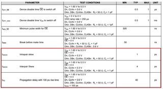

I would like to switch high-speed data of 10ch or more using multiple TS5MP645s.I would like to estimate the part to part skew in that case. But it's not mentioned in the specs.As an estimation method, there is a method of calculating the skew between parts using the maximum and minimum propagation delays and minimum and maximum skews, but the TS5MP645 specification only lists standard values for propagation delay and skew.

    I understand that TS5MP645: Ron & Con are very small, so the propagation delay is determined by the combined value with the external load, and the maximum propagation delay is calculated by the maximum value of Ron and the load capacitance. The skew between parts when using multiple TS5MP645s is TD(min)=Ron(min)*C(Con+Cload), TD(max)=Ron(max)*C(Con+Cload).
    For example here
    Ron(max)=6.5ohm Ron(min)=0ohm (*Ideal value because spec is not stated)
    Con=1.5pF (*Only Typ is listed in the spec)
    Cload=2pF
    →TD(max)=22.75ps
    → TD (min) = 0 ps (ideal value for design margin).
    Therefore, the maximum part-to-part skew is 22.75 ps when the Ron difference of different TS5MP645s varies to the maximum.
  • I wouldn't necessarily use the 0ohm condition/ideal as your min. The device will never produce 0ohms but if this is just to provide extra headroom for design margin then I supposed it wouldn't hurt. I would expect this min RON value will be closer to the RON value (think ~2ohm), which would give roughly a 15.75ps skew. This of course is assuming only a 2pF load and no other trace/board capacitances. As those increase, that overall system skew will increase as well. But this value is a good approximation for just the impact of the device-to-device skew.
