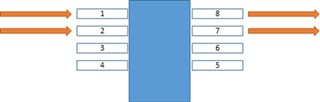

Does TI have a suitable MUX solution like this structure? for differential layout fluent. thx

Are you limited to having a 8 pin mux? If not i suggest the TS5A23157, it is a 2 channel 2:1 switch but it can be used like a 2 channel 1:1. If un used outputs are tied to ground through a termination resistor.
Check out this FAQ that talks about LVDS mux selection guide
