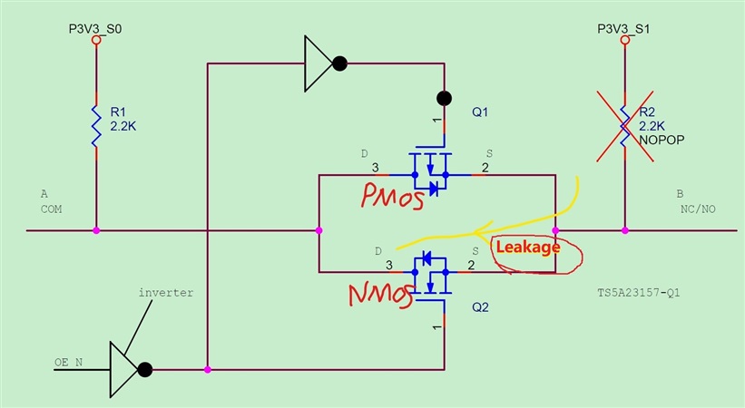

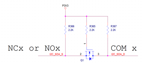

When the TS5A23157-Q1 is used as an I2C switch, do both NC (NO) and COM require pull-up resistors?

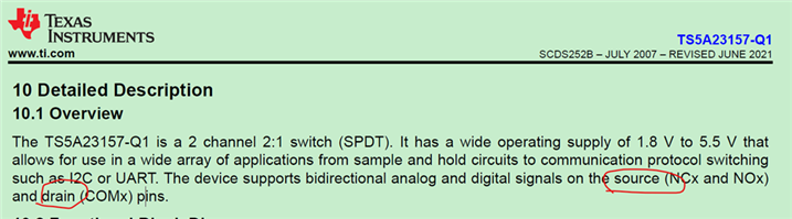

Because the datasheet does not describe the internal structure of the switch in detail, I wonder if the structure between (NCx and NOx) and (COMx) of this switch is similar to the CMOS shown in the screenshot below?
