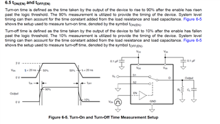

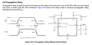

I was looking at timing diagrams for this IC and i saw that there is a tr and tf even when they did not talk about it in the specification. May I ask for the actual rise and for time for the 15V supply of this chip? Thanks!
