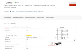

  • In that case, could you please remove the 5V item from the power supply listing on the TMUX131 product webpage?
    I'll likely use the TMUX1309A as an alternate.
  • Hi John
    Understood and our team will be working on that in the next ti.com update.

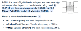

    Understood and just wanted to let you know that I actually recommended the TS5A3357
    Its Performance at the frequencies for RGM should be fine  and the bandwidth should be enough here
    Please let me know if you have any other questions.
    Kameron
  • Kameron, to clarify, in my original request, when I mentioned RGM, I was referencing the TMUX131 package type. We will be MUXing CAN bus signals.
  • Hi John
    My apologies on the mis-read here.
    The TMUX1309a should be fine here
    Please let me know if you need any help in the future Regards,
