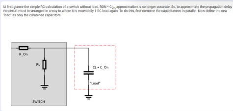

    1.This device can support a 66MHz SPI signal with its bandwidth being 240MHz( 3x times the signal frequency)
    This app note talks about selecting a multiplexer based on bandwidth and the performance of this device will look similar to the second set of images on this picture
    2.The propagation delay of analog multiplexers is actually load dependent so the load connected to the multiplexer will be the determining factor of propagation delay in a design.
    I would actually recommended the customer to read this FAQ to understand this topic and greater detail and be able to estimate the actual propagation delay in the design
    Please let me know what you think about this information and we can continue to discuss.

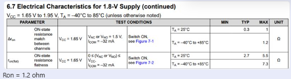

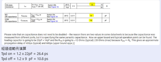

  • Hi AE,
           Please kindly confirm whether the calculation method is correct.
           The Tdp calculation method is summarized as follows.
           1. Tdp = Tdp on + Tdp off
           2. Con = 22pF, Coff = 9pF
           3. Ron = 1.2 ohm
           4. Tdp on = 26.4ps, Tpd off = 1.2 x 9  pF = 10.8 ps
    Best Regards

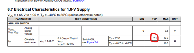

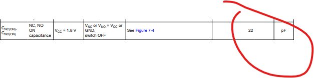

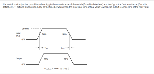

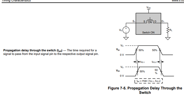

  • Hi Robin and Bruce
    Apologies for the delay as I was OoO for the last few days
    So just to clarify
    Propagation delay is actually the delay between the signal on the input pin passing though the device and showing up on the output pin( Propagation delay is measured when the switch is on or closed ) Another way to say it is propagation delay is how long it takes for the input signal on a on channel to show up on the corresponding output pin it is connected too.
    So if we look at the TS3A27518E at 1.8V supply then we get a typical ron of 7.1 ohms and con typical of 22pf
    Tpd= ~ 7.1 x 22= 156.2 ps ( This is the approximate propagation delay for the switch path alone and in most applications prop delay is mostly load dependent and can be accounted for if added into the calculation according to the FAQ i sent earlier)
    Also just to reiterate prop delay is measured when the switch path is closed/on.
    off propagation delay isn't something measured by our team because when the switch path is open/off the path is high impedance meaning signals should not pass through the device.
    Please let me know if this helps and I can explain further if needed.
