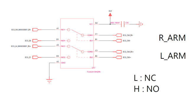

TS3A24159: Is the very high current consumption normal???
Part Number: TS3A24159
When VCC of the TS3A24159 is supplied with 3.3V and the VIN logic is operated at 1.8V, the current consumption in the NO (Normally Open) state rapidly increases to more than 1.7mA.
However, testing has confirmed that when VCC is supplied with 1.8V, the current drops to a normal level in the nanoampere range.
Is this normal case?
