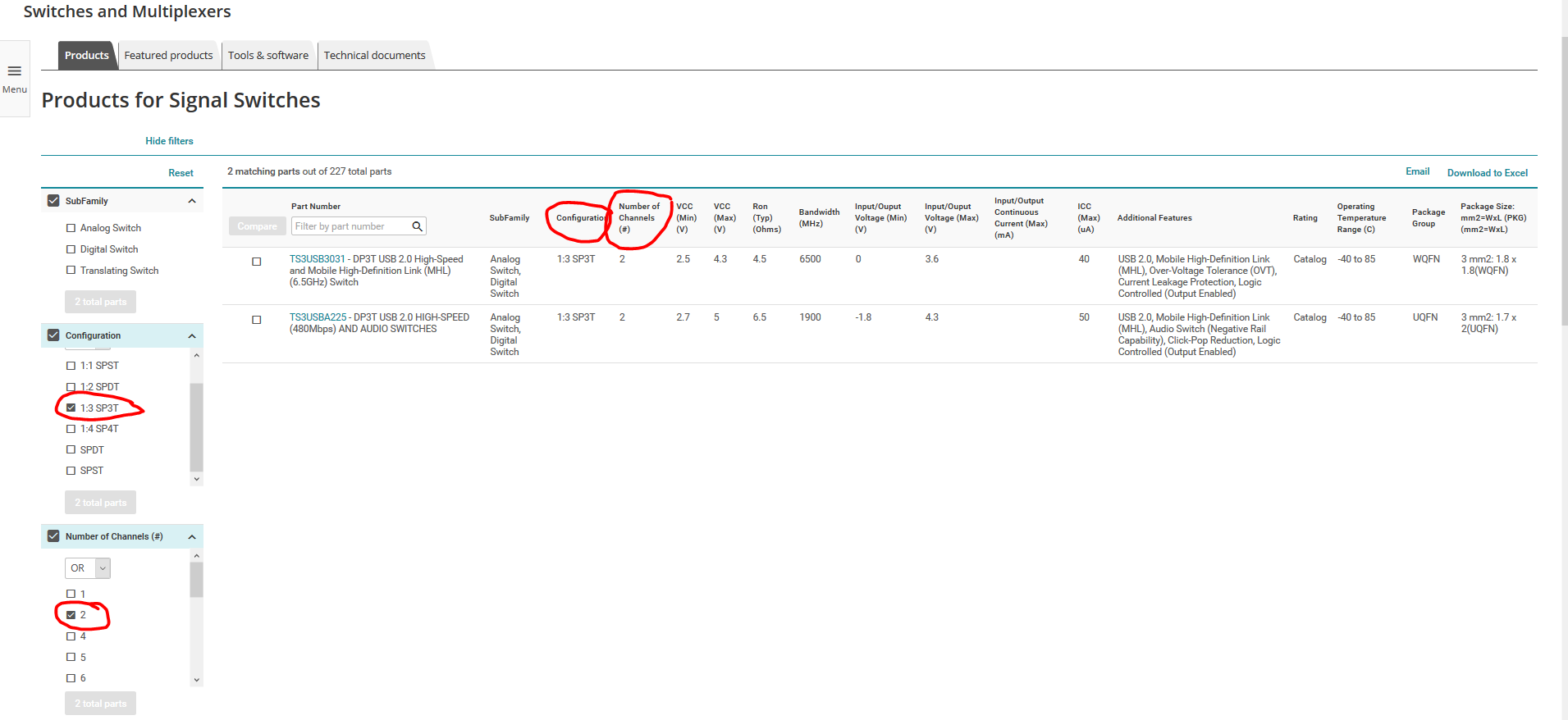

    To find a switch for this application I used the ti.com switch selection tool.  I used the filters on the left hand side and selected 2 channels (one channel for TX/D+/SDA and one channel for RX/D-/SCL) and 1:3 SP3T configuration.  I would recommend using the TS3USB3031 for your UART/USB/I2C mux application.
