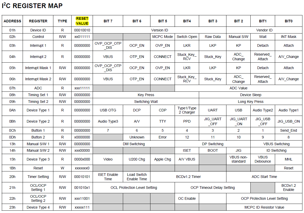

TSU6721 - switch default state
Guru 20090 points
Could you please let me know the default state(after SW reset) of interhanl switch matrix?
Are these all switch off?
Ryuji Asaka
  • Hello Ryuji,
    "Could you please let me know the default state(after SW reset) of interhanl switch matrix?
    Are these all switch off?"
    Absolutely. The best reference is the I2C register map, which will provide the switch values upon reset.
    Please let me know if this answered your question and/or if you have any more questions.
    Jared
