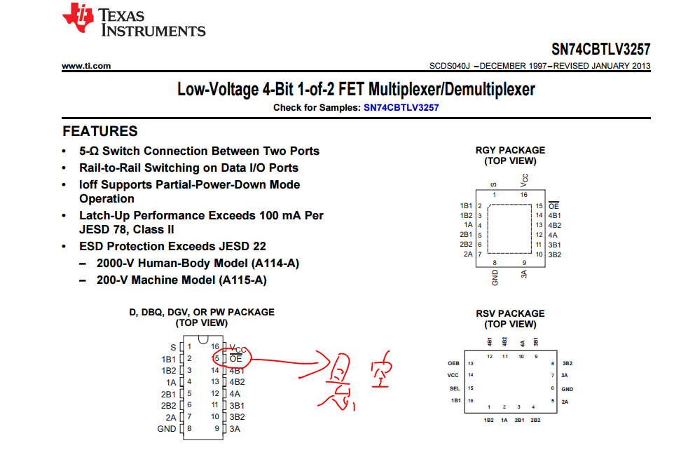

SN74CBTLV3257: Whether we can leave the OE pin open(float) on the board
Part Number: SN74CBTLV3257
Hi team,
Whether we can leave the OE pin open(float) on the board? Currently my customer float it and test the voltage is about 200mv. We want to check whether it has risks. in my opinion, we need to pull down the pin in stead of float, float may have risks, also want to double check with you. Thanks.
