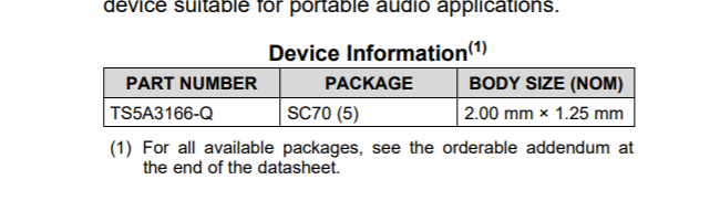

in the Ds of TS5A3166-Q1 there is a YZP package but the part seem not to be available is that correct?
D.
  • Hey D,
    I'm not quite sure where you're seeing the YPZ package. Perhaps you've inadvertently looked at the catalog TS5A3166 datasheet instead of the automotive TS5A3166-Q1? Here's what I see on the datasheet for packages on the Q1 version.
    So there's only the DCK (SC70) package available in this.

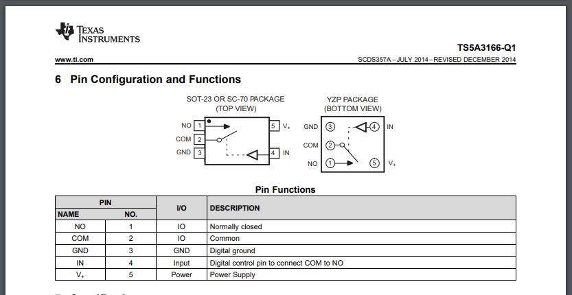

  • Hi Rami,
    on page 3 there is a picture with YZP package
    Br.
  • D.
    I looked into this more and there never was a YZP package available for the Q1 version, so this appears to be an error in creating the datasheet using the non-Q1 as a template. I'm sorry about that. We'll revise the datasheet accordingly.
