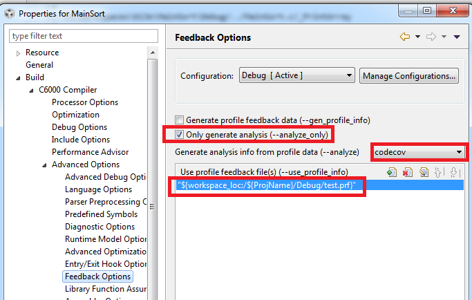

  • Note that one workaround that seems to work is to manually fix all the paths in the prf file and then re-compile using the modified profile feedback file. This should create the correct csv file. You can do this from CCS:
  • Hi Ki,
    Thank you for following up on this thread. Ok, fixing the path manually in prf file works to me! Thanks.
    I expect the fix in the future release on CCS/CGT.
    Now I close this thread.
